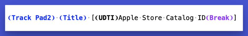

The simple template we previously displayed has been updated to append the Apple Store Catalog ID enclosed in square brackets. When inserting UDTIs the name of the item must immediately follow the ❨UDTI❩ token. We use a ❨Break❩ token to separate the name of the UDTI from the trailing ] that is being inserted. Break tokens serve no purpose other than safely terminating a text sequence. Note that any token foillowing a text sequence will serve as a break.
There are two other break tokens which are used to simple retain spacing in a template for visibility reasons. Templates are stored compiled and are automatically formatted when displayed. The ❨Break\❩ token will be followed by a newline character. The ❨.❩ token will be preceded and followed by empty lines.

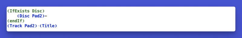

Conditional Insertion
Assume you want the template above to be modified to insert the disc number padded to two spaces but only if it exists. In this case exists means not empty or zero. If it does exist we want the disc number followed by a dash. Also test for the existence of the Apple Store Catalog ID before inserting it.
――――  Renaming and Restructuring 3
ren2
The IfExists field token implies that the following text and tokens should only be evaluated up to the next Else or endIf token, if the field exists. If the field does not exist and an Else token is supplied, all text and tokens after the Else until the matching endIf will be processed. In the above example if the Disc field exists, we're inserting it padded to two characters followed by a dash character.
We use the same technique to test if the Apple Store Catalog ID exists. If it does we insert a space followed by [ followed by the UDTI's value followed by ].
As a convenience, there is a special form of the IfExists token which implies if the specified field exists, insert it immediately after the token. The previous template can be simplified to:

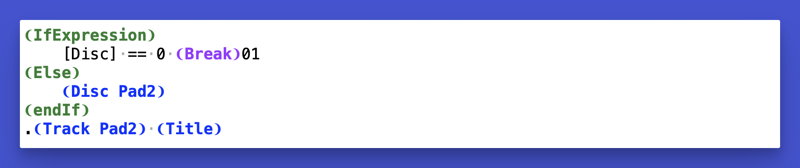

Tokens which begin with the following names treat a numeric value of 0 as being equivalent to empty: Disc, Episode, Movement Number, Season and Track. Any custom field defined as being a Yes/No value will also treat a numeric value of 0 as equivalent to being empty.

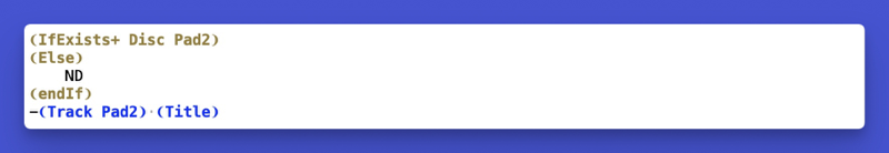

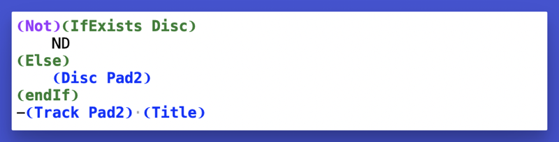

As a somewhat silly example, let's say we want to specify ND if there is no disc number.
――――  Renaming and Restructuring 5
ren4
Note that we have no items before the Else token as we only want to do something when the Disc field is empty or 0.
At times it may be easier for you to specify a negative condition. The Not token can be used for this purpose.
――――  Renaming and Restructuring 6
ren4_1
The Not token must immediately precede an if token and flips its evaluated result. In this case does Disc exist becomes if Disc does not exist.

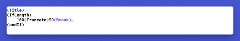

If you wanted to limit the length of a name to 100 characters, you could do the following:
――――  Renaming and Restructuring 7
ren5
The above template inserts the Title field and then tests if the result is longer than 100 characters. If it is, the name is truncated to 99 characters and a horizontal ellipsis (...) is inserted. In the above example the IfLength and Truncate tokens read the following text field for the number. If for any reason, number is followed by text a ❨Break❩ token must be used.

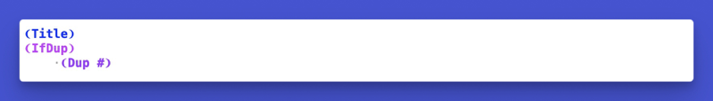

Duplicate Handling
It is entirely possible that when you rename files you will end up with a duplicate filename. For example, if you're renaming files to the Title field, and more than one track is named Intro. Yate allows you to handle duplicate filenames in the template. You can insert whatever text and/or tokens you wish inside of the duplicate sequence. However, it is typically better to let Yate pick a single number to differentiate the copies.
――――  Renaming and Restructuring 8
ren6
The above template sets the name to consist entirely of the Title field. If it is a duplicate, it adds a space and the first available duplicate number.
Duplicate processing, can cause issues with removing trailing spaces and underscores as a duplicate sequence can be added at the end of the path component or filename. The template advanced setting Apply transformations for IfDup, applies various transformations before the insertion point of a duplicate sequence. more information can be found on the help for the advanced rename settings panel.
It is strongly recommended that all rename templates which have a filename component, specify an IfDup, Dup # sequence. This is especially true when using a rename template when moving files. The duplicate handling enables the Keep Both option when a file already exists. In practical usage, all the preceding examples should have had duplicate handling tokens.

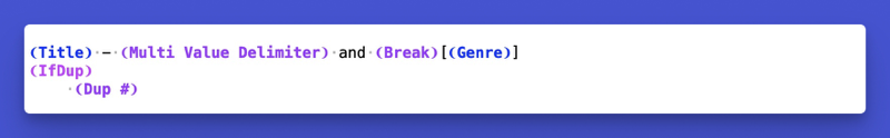

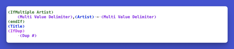

Multiple Values in Fields
There are two methods of handling multiple values in fields. If the Settings - Rename Multi Value Delimiter substitution setting is empty, all values following a multi value delimiter (typically ;;;) are ignored. If the setting is not empty, multi value delimiters are replaced with the specified text. As an example, if you specify " and " as the rename substitution, all ;;; sequences will be replaced with " and ".
You can also use a ❨Multi Value Delimiter❩ token to override the rename substitution setting in a template. These tokens can be specified as many times as desired in a template to provide complete granularity on how multi value delimiters are processed. If the token is followed by text, the text becomes the replace substitution value. If the token is followed by another token, the replace substitution value is set to empty. The following example overrides the default value only for the Genre field.
――――  Renaming and Restructuring 9
ren7
The above template renames each file to Title followed by [Genre] where multiple items in Genre use and as the delimiter. Note that the Break token is used to force a no text situation before the "[" text which is being inserted before the genre.

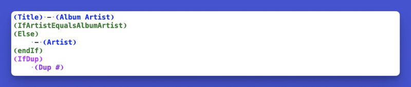

The IfArtistEqualsAlbumArtist token can be used to construct a sequence depending on whether the Artist field is equal to the Album Artist field. As an example assume that you want a filename to be the Title followed by Artist if is not the same as Album Artist.
――――  Renaming and Restructuring 11
ren9

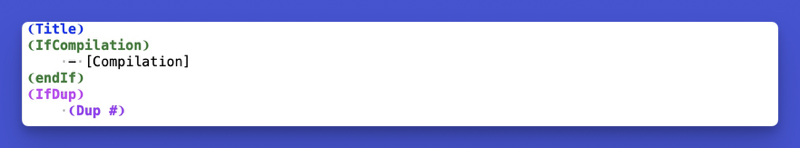

The IfCompilation token can be used to determine if a track has Part of a Compilation set. As an example, let's append -[Compilation] to the filename, if appropriate.
――――  Renaming and Restructuring 12
ren10

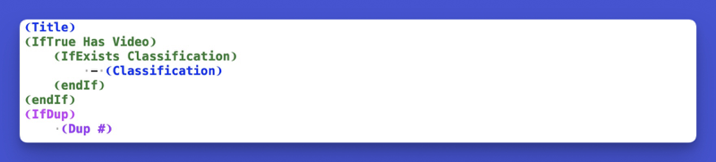

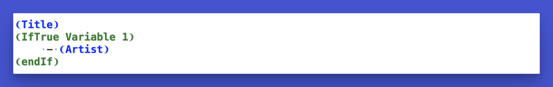

The IfTrue and IfFalse tokens can be used to test if a condition is true or false. The condition can be one of the following: a property test such as hasVideo, a test if a file is a particular audio type, a test if a track variable is true or false. A track variable containing true (case insensitive) or starting with any non zero intereger value is considered to be true. Any other text is treated as false. As an example assume that a filename of Title has the Classification field appended if the track contains video and Classification is not empty.
――――  Renaming and Restructuring 13
ren11

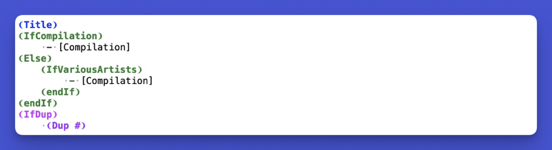

The IfVariousArtists token is used to test if the file's Album Artist field contains Various Artists (case insensitive). If the Album Artist field contains multiple items separated by the multi value delimiter, true will be returned as long as one of the items is Various Artists. As an example let's expand on the IfCompilation example to treat any album with an Album Artist field of Various Artists as a compilation.
――――  Renaming and Restructuring 15
ren13

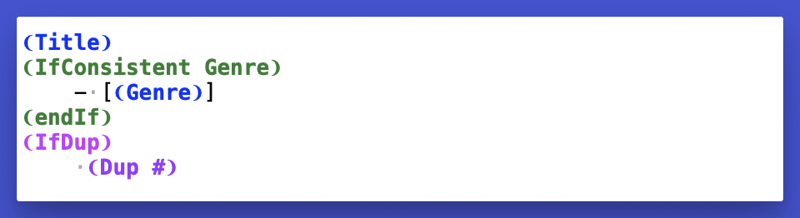

The IfConsistent token tests if an item is consistent (exactly the same) in all files. In the previous example, Genre will only be appended to the Title if it is exactly the same in all files.
One flaw in this example is that it is possible that Genre is exactly the same in all files but is empty. The IfConsistentNotEmpty used in the next example handles this case.

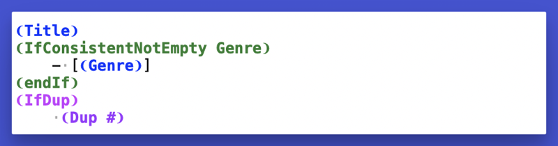

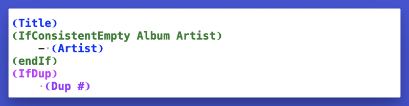

The IfConsistentNotEmpty token will only be true if all files have the same Genre field and are not empty.
Last but not least for the IfConsistent tokens is a test to determine if the specified item is empty in all files.
――――  Renaming and Restructuring 19
ren16_3
This example will append the Artist field if Album Artist is empty in all files.

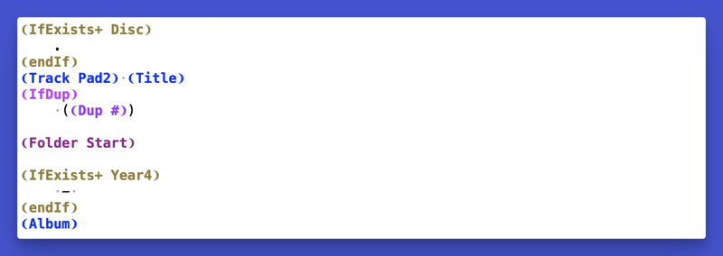

The following example renames the folder to the year component of the Year field followed by the Album field:
――――  Renaming and Restructuring 22
ren16
You can rename more than one path component by specifying multiple Folder Start tokens. All renaming is done right to left in a path. The start of a template defines the structure of a filename. The text and tokens after the first Folder Start token specifies the name of the folder containing the file. The second Folder Start token renames the folder containing the folder which contains the files. etc.

――――  Renaming and Restructuring Snippet 26
Test if the Album Artist field is not equal to "\[Artist]" (Set test state and Variable 1)
Rename Files (Renaming and Restructuring - 26)
Here's a tip. When you have actions such as the ones above which essentially simply do renaming, you can place the action on the rename menu. In the Action Manager, select the action and from the context menu choose, Add Association>Rename (or click in the Menu column).

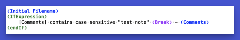

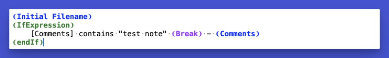

The expression is true if the Comments field (default) contains the case insensitive text test note. When true, the Comments field is appended to the filename.
――――  Renaming and Restructuring 28
ren22
This is identical to the previous example with the exception that the comparison is case sensitive.

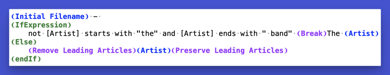

The expression is true if the Artist field does not start with the and ends with space band. When true the word The inserted at the start of the inserted Artist field. When false, leading articles are removed before the Artist field is included.

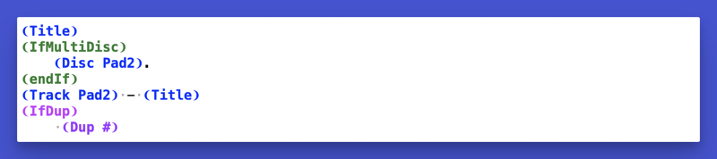

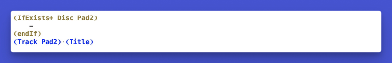

The template is used to rename tracks to dd.tt title. The IfExpression token is used to change disc numbers of 0 to 1.

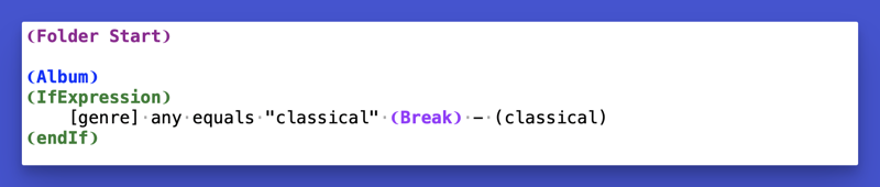

The template is used to rename containing folders to the Album field. If any item in the Genre field is Classical, - (classical) is appended to the folder name. In a rather constructed case, this would work if the Genre field was Folk;;;Classical.
――――  Renaming and Restructuring 32
ren26

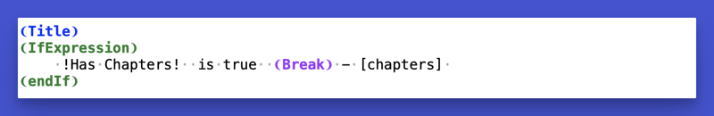

The template is used to rename tracks to the Title field. If the file has chapters, - [chapters] is appended.

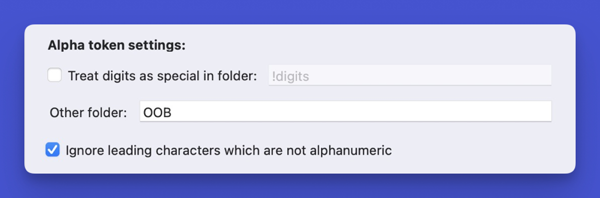

The Alpha folder component consists typically of a single character. This list of single character folders makes it easier to find artists in a large collection. The Alpha token settings are provided in Settings - Rename - Settings. One possibility for settings is as follows:
alphasettings
All leading characters are ignored except for alphanumeric characters. Digits are not treated as special. While doubtful, any item which does not start with an alphabetic character is placed in an OOB folder.

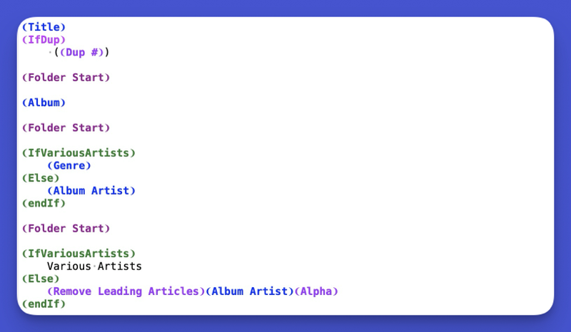

The rename template supplied to the wizard is as follows;
――――  Renaming and Restructuring 34
ren27

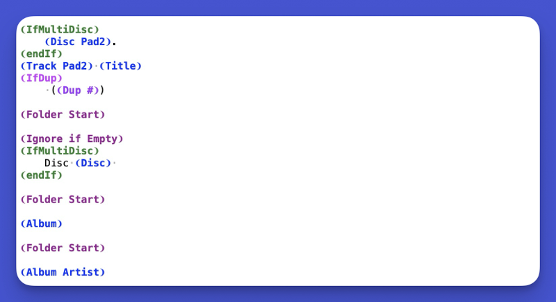

The following example is for those of you who want to use Disc subfolders for multi-disc albums. A single rename template will work with single and multi disc albums.
――――  Renaming and Restructuring 35
ren28
The template only generates a Disc subfolder is a track has a Disc or Disc Count field which is greater than 1. The IgnoreIfEmpty token, causes the entire Folder Start component to be ignored if the multi disc condition is not met.
When using the wizard it is strongly recommended that you do not disable folder validation unless you are intentionally moving content in a single folder to multiple folders. It is always a good idea to enable logging as that way you have a record of where each track was relocated ... even when not batch processing.
