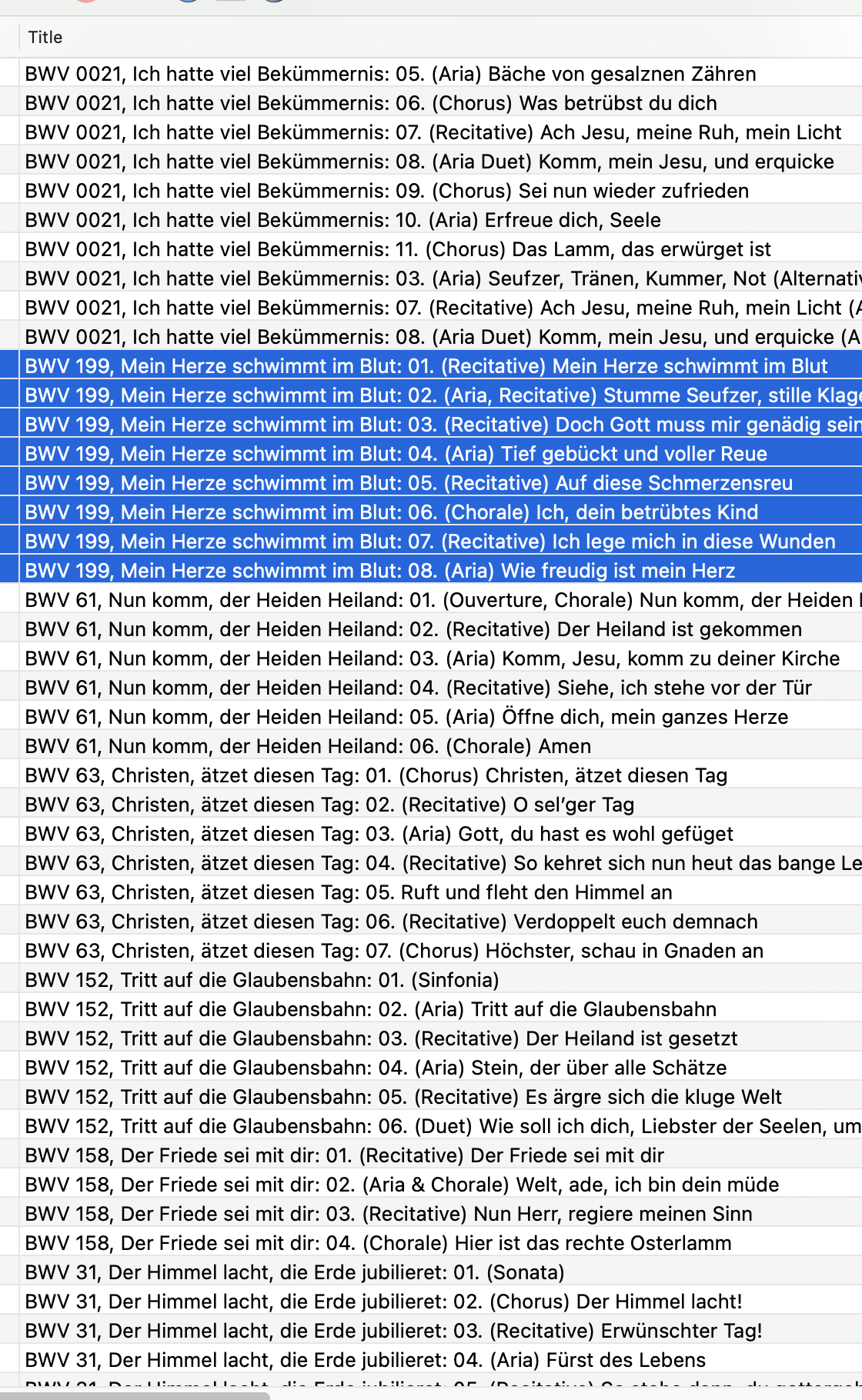

I like to have the BWV numbers at the beginning of each line of the Bach sets padded to 4 digits, so that they line up neatly. The problem is that the start number varies from 1-4 digits (and obviously, the 4 digit ones don't need padding).
Is there a way to automate this?
In this case it will always be preceded by "BWV-space" so there's a handy pattern.
In a different scenario the pattern might be different so I'm wondering...
Is this something that's tucked away in Yate?
If an action is required, could a pattern be entered manually & an amount of padding be dictated so that I can use it elsewhere?
