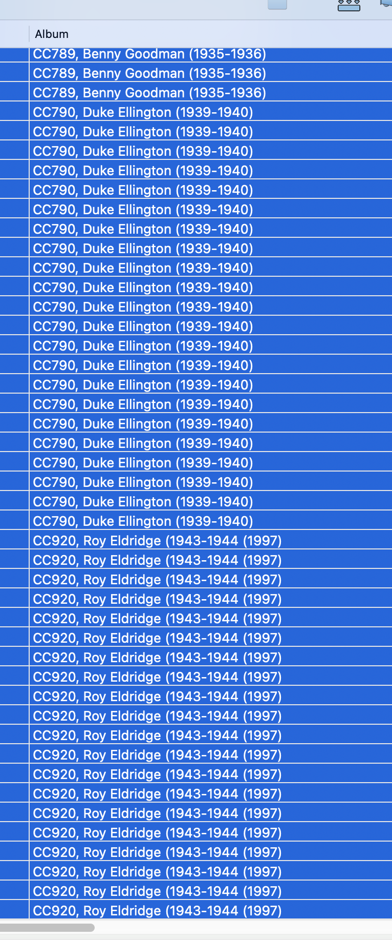

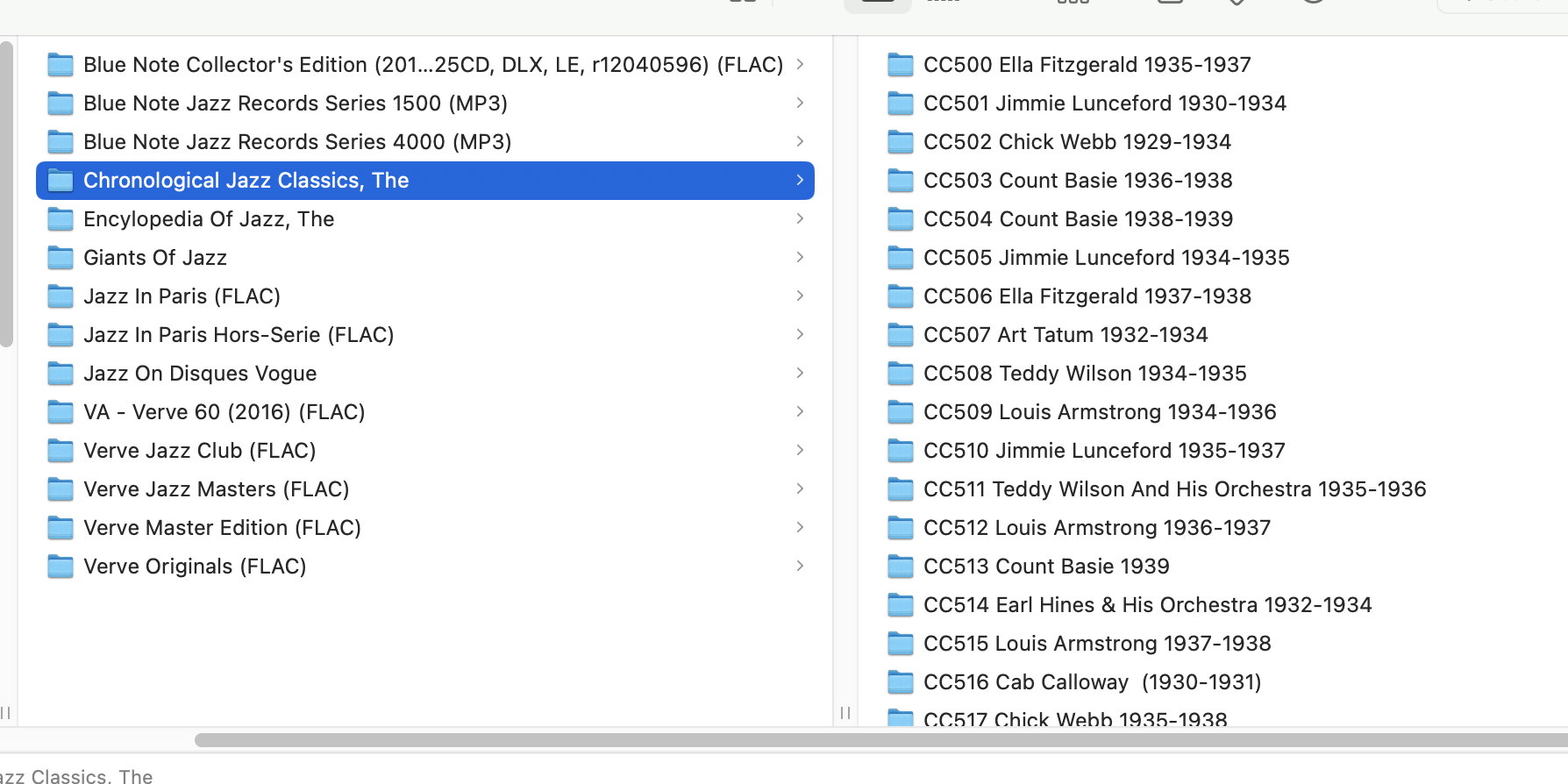

Basically, as the title says, I've modified the album titles within Yate in a way that I can't in the finder (essentially adding a comma after the cat. no. & putting the dates in brackets, but there were a few misc. niggles along the way).
So now I'd like to use the revised Album field as the names of the folders in the finder.
