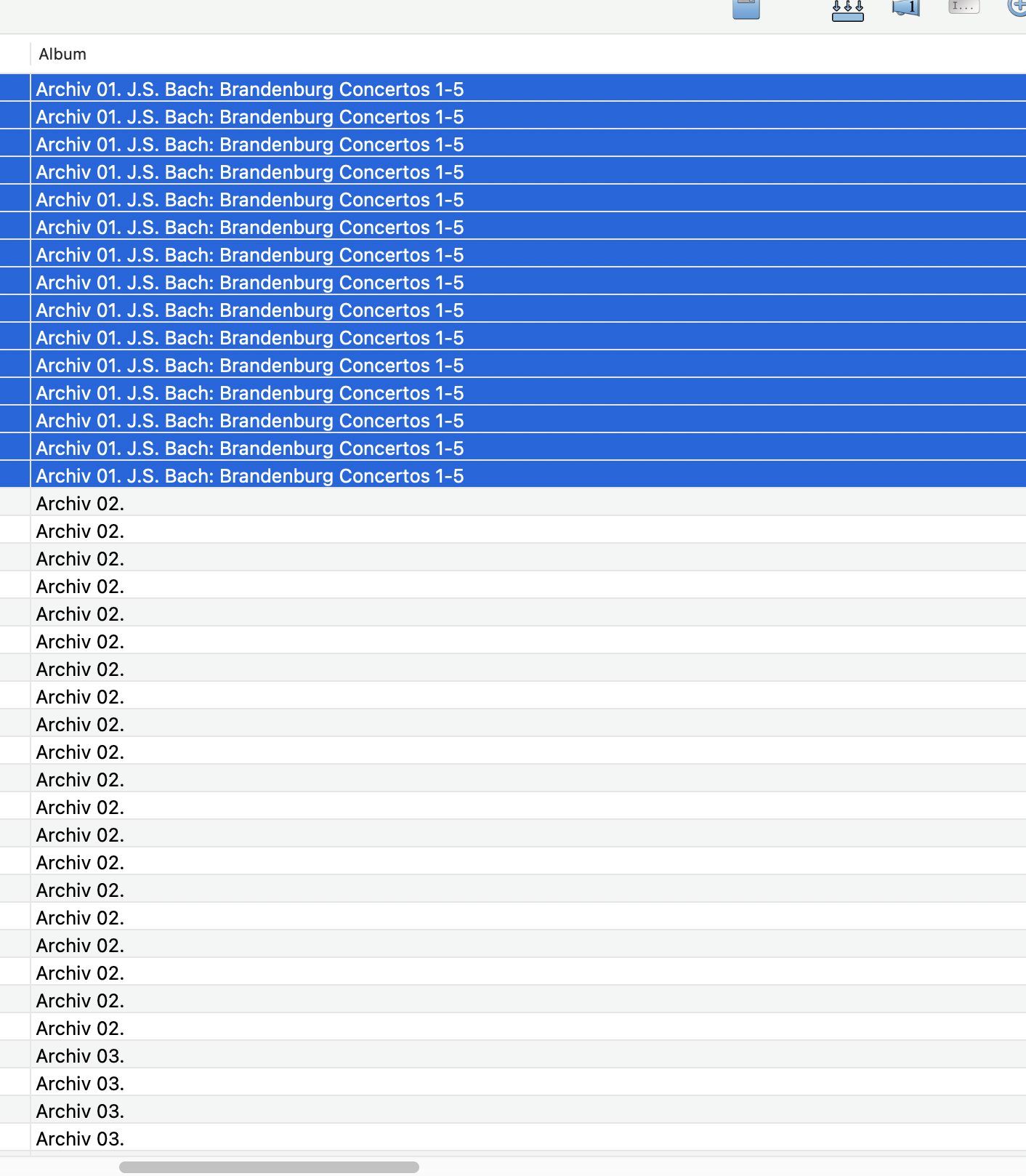

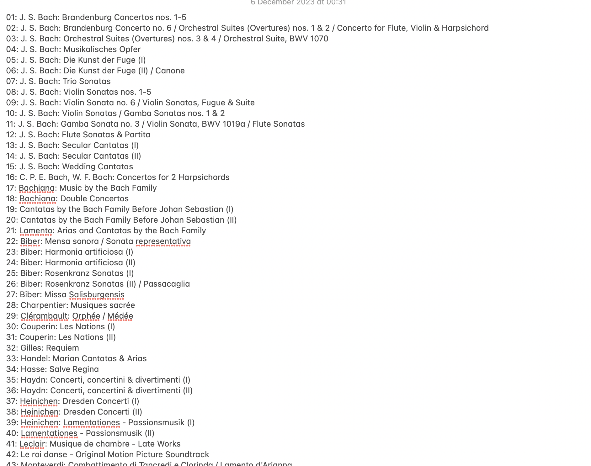

In the first screenshot, you'll see that I already have the disc numbers included in the album field & that disc 01 has 15 tracks, so Yate would paste the first line of text (beginning 01, as seen in screenshot 2) into the first 15 lines of the album field, then take line 02 & add it to all the tracks of disc 02, etc. etc.

The first album, once I've gone in & tidied it up a bit, would end up looking like the following screenshot.
I'm not especially worried about ending up with double numbers or extra colons, I can tidy that up easily enough. There's even a word space after the number that's already in the album column, so just tacking the text from the clipboard onto the end of what's there would be perfectly adequate.
