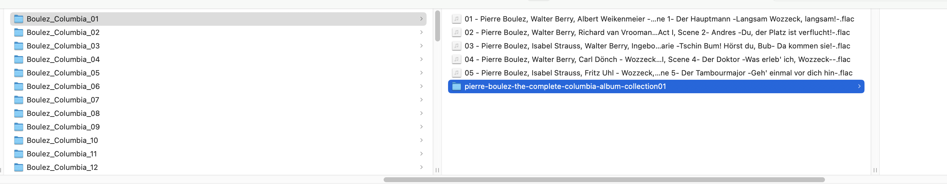

I have a 67 disc box set that had all the tracks for each disc inside a folder inside another folder. I used the action to "move files up one folder & delete empty folder", but there was a little text file inside each folder, so the folders are still there. I used the finder to search & then delete all of the text files & I now have 67 empty folders that I'd rather not delete one at a time.
Is it possible to have an action that simply finds empty folders & deletes them without moving any files?
