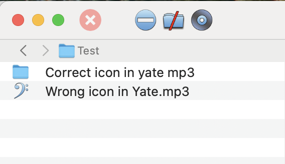

Folders in Finder that ends in filetype designations such as ".MP3", ".aac", etc. are visually shown in Yate as files, and not folders, despite being the latter. Yate still knowns that they are folders, so it is only the iconography which is wrong. See screenshot of two folders, where one of them have the wrong icon in the list view.

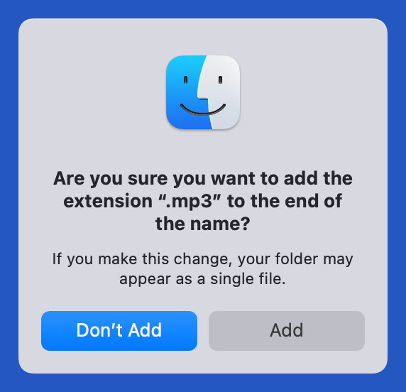

True and while I though this was a bug it seems that some versions of the OS (such as Sequoia) get confused with an extension on a folder. The folder property seems to be somewhat messed up and is designated as a file for a variety of Open functions.
See Sequoia's popup when trying to set an .mp3 extension on a folder.
I strongly suggest that you get rid of the extension and tack on -mp3 to the end of the folder name.
