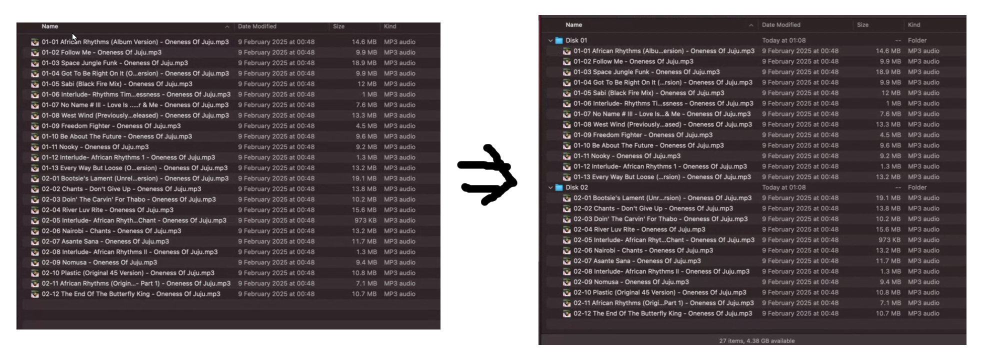

Hello everyone,
I have tried for several days with the "Create Move Action Wizard" function.
But I don't get to my ends. 🙄
I have a unique folder that contains files from a multi-disk album.
I would like to create sub-folder corresponding to the different discs. (Disk1 folder and Disk2 folder for example).
And then he moves the files corresponding to the discs in the subfolders.
Thanks in advance

2MR2PostFebruary 20, 2025, 22:51
Normal topicSubfolders for MultiDisk
Download the action at https://2manyrobots.com/actions/Move-to-Disk-Folders.zip
The action is named Move to Disk Folders
Select as many files as you want. They can be in different folders. ie. the action can handle multiple folders at a time.
All tracks already in folders named Disk ## are ignored.
Every other track will be moved to a subfolder named Disk ##. If a track's Disc field has an integer <= 0, 1 is assumed.
Give it a try. It worked for me in my tests.

Back from the weekend,
I'm trying your action.
It works perfectly.
Thank you for this action and thank you for developing this wonderful tool that is Yate... 🙂
