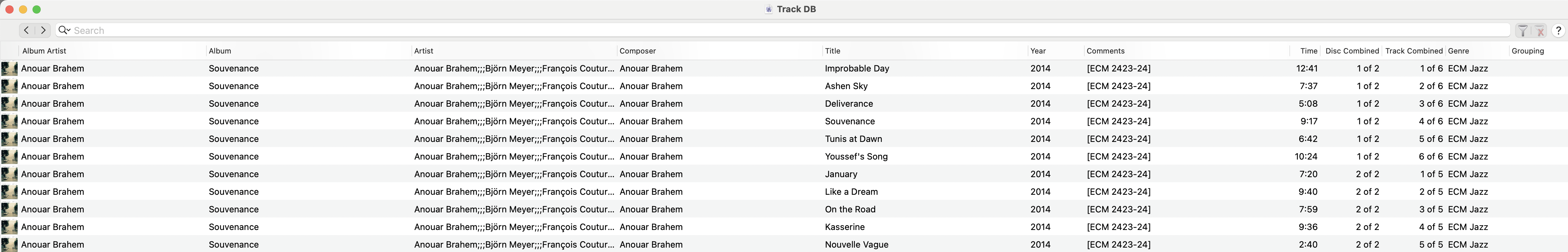

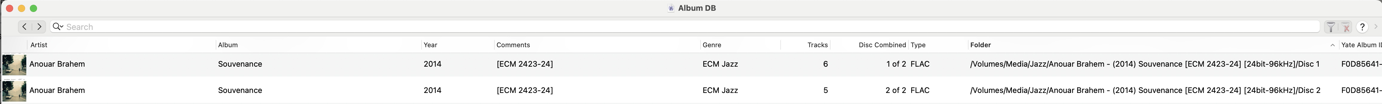

When I build my databases using the Create Database Utility action, an album that contains more than 1 disc is listed as shown below, 2 separate discs in this case, for both the Albums and Tracks databases. This is what I expect.

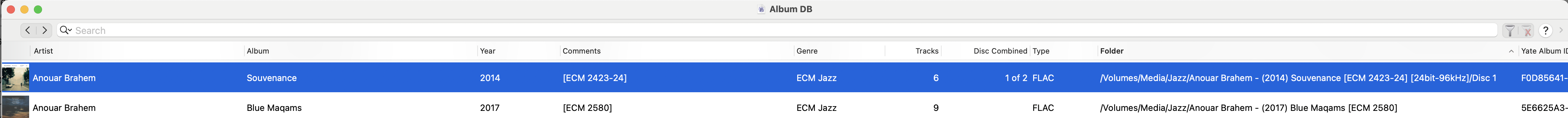

On the other hand, if I add the album via the Update Databases context menu, only disc 1 appears in the Albums database. The Tracks database is fine, showing the 2 discs.

If I then add that album via File > Database Functions > Update Databases, only disc 1 appears in the Album database.

If I run the Create Database Utility action with the Create Yate Album IDs if missing option on the source folder of my library, that same album gets listed on 2 rows (Disc Combined > 1 of 2, 2 of 2) in the Album database AND each disc gets its own unique Yate Album ID, so 2 different Yate Album IDs for the album.
