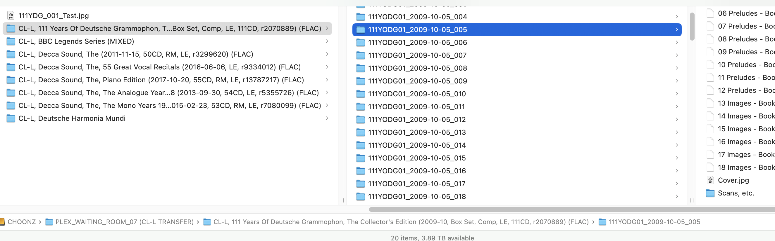

Hi there.
I have a 111 disc box set.
Each folder contains an image file called "Cover.jpg"
I'd like each image file to have a unique name based on the disc numbers & the easiest way to do that in this case is to prepend the folder name to the cover image, joined by an underscore.
Can I do this "out of the box"? I can see how to prepend the folder name using "set" but I can't see a way of telling it to affect the image file.
(I do have an action for adding the disc number to an image file but in this case I'm not using disc numbers because the 111 discs come in two sets, 1 & 2 so the disc numbers revert back to 1 at the beginning of box 2 & that caused some problems with Roon.)
Here's a screenshot of what I'm on about. Does the question make sense?

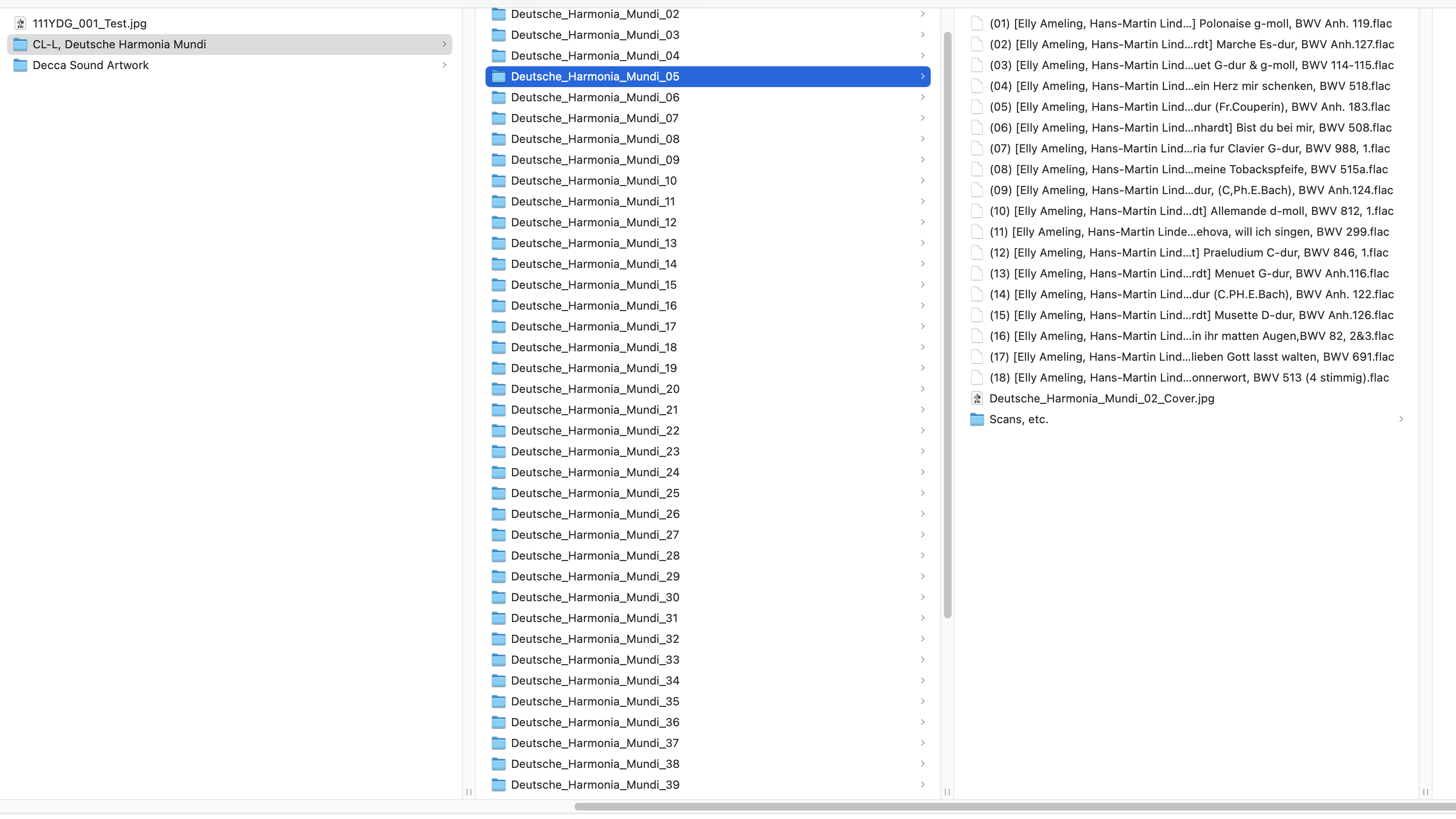

I seem to be having a bit of an issue with this whereby it's prepending the same number to each of the image files & not the unique folder.
(It actually did this the first time I used it & I didn't even notice as, in that instance, the disc number was a bit buried amongst some other numbers.)
Curiously, where it used number 1 in the first instance, this time it's using number 2.

SnowdogPostMay 14, 2025, 08:51
Posts: 377
Normal topicPrepending folder name to image file
Yes, but each containing folder contains the disc number and, as you can see from the screen shot, it's prepending number 2 onto number 5 where it should be taking each unique folder & prepending it to the image "Cover.jpg" contained within.

2MR2PostMay 14, 2025, 09:46
Posts: 2477
My bad. I should read my own documentation. Escape sequences are only done once. I can't do all the files at one. It must be done per folder.
I'll fix it using any file which ends in cover.jpg. no need to fix anything.
