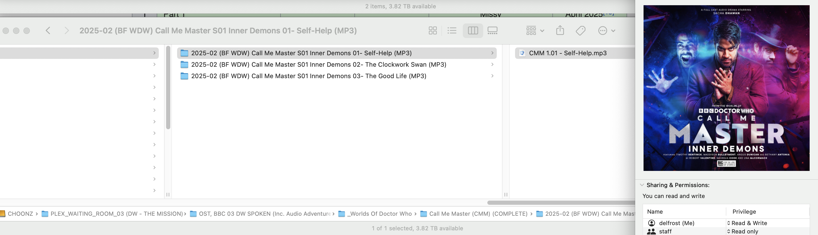

I have a whole load of MP3 files that have embedded cover art. (You'll notice in the screenshot that there is only one file in the folder (an MP3) but a "get info" shows it has a cover embedded.)
My general process is to take the MP3 into Yate, save the embedded image out as an full quality JPG, re-name the resulting JPG to something ending in "_Cover.jpg" then delete the embedded cover image & bring in the file I just created but there are thousands of these & I just need to speed up the process.
It doesn't really matter what the cover image is called & I guess the action will need a pattern so would it be easiest to make the image name the same as the file name but with all word spaces & full points changed to underscores, so that:
CMM 1.01 - Self-Help.mp3

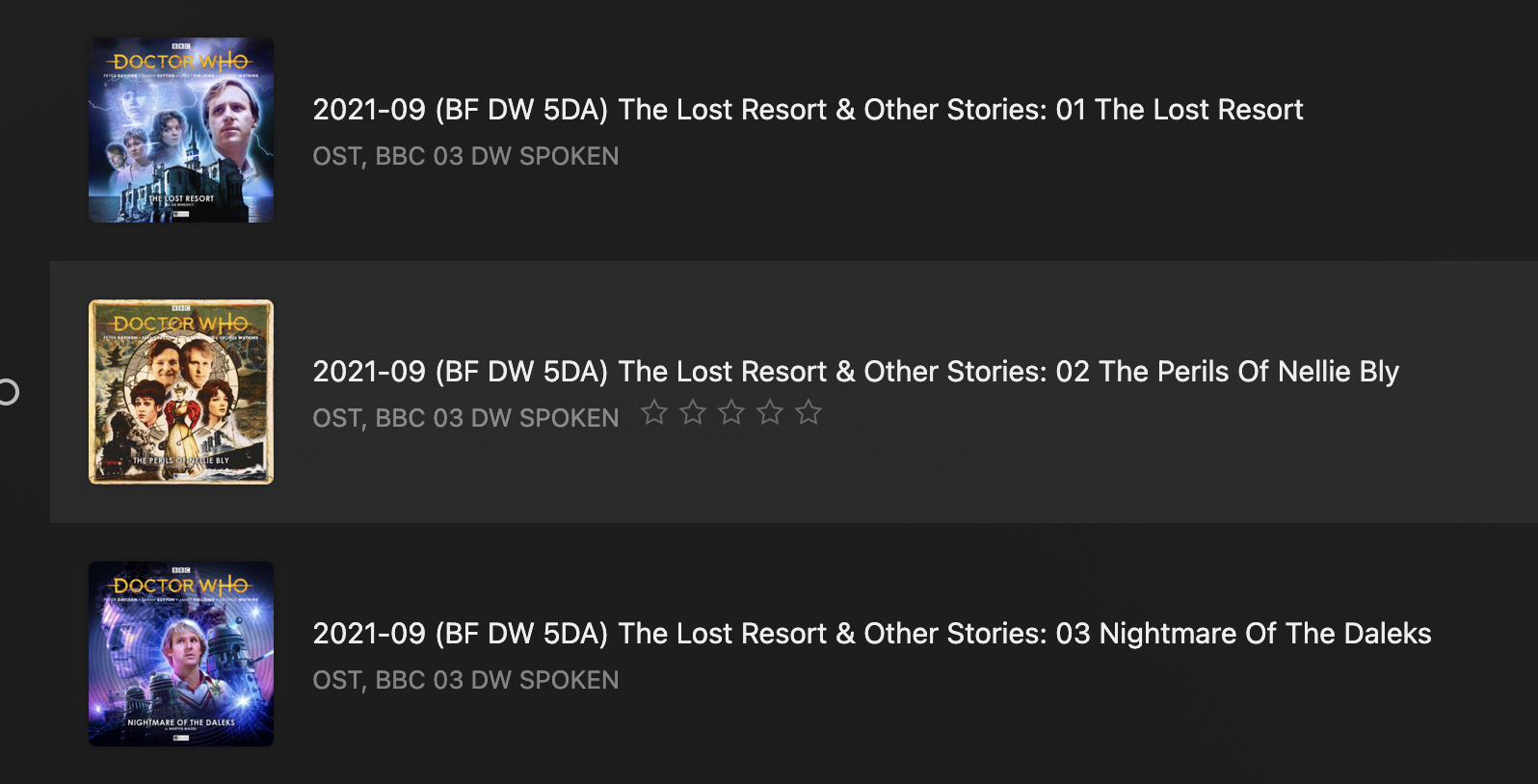

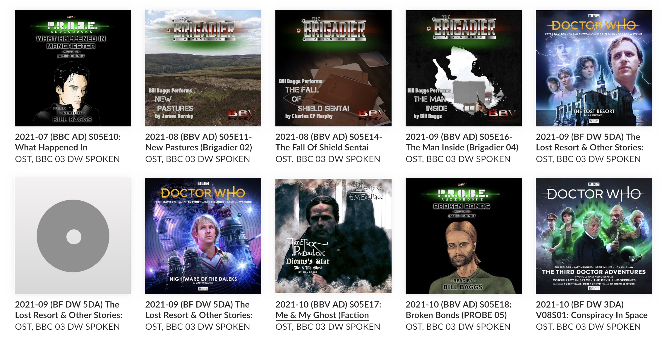

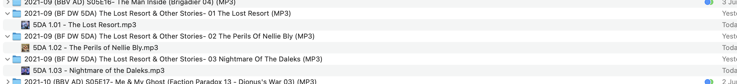

So I've been leaving the embedded sleeves & seeing how I get on. I've added dozens without a problem but today I got my first "problem child".
You'll see from the screenshots that:
1) Each folder contains a single MP3 with an embedded image.
2) That the embedded images show up perfectly well in Plex.
3) That Roon's decided to be a twat about it & not load one of the images.
I've jumped through all the hoops, reloaded it, restarted it, cleared the caches. All the hoops! But to no avail.
This is one of the reasons I'm hoping that, once I can get everything set up & can be secure in the knowledge that I can get good quality audio to my hi-fi from Plex, that I can finally dispense with Roon. (I currently only have Plex because Plexamp works really well in the car, but it does mean I have to curate two music libraries in parallel.)
Anyway, if it's just the occasional one, I can manually create the cover image but if it gets any worse, I may be asking you for an action that saves out the embedded images & renames them. 😆

Is there anything strange about the embedded artwork item? Right click on the image in a Yate artwork well and select Get Info. Perhaps the image has a strange resolution or is a progressive jpg. Lot's of applications do not like progressive images. Try saving the image to the folder as folder.jpg. This can also be done from the context menu.
SnowdogPostJune 10, 2025, 18:43
Normal topicCreating standalone image from embedded image
Yes, it turns out the image was over 4000 pixels square, so I had to downsize it.
I've encountered images that exceeded the maximum size for FLACs before but, as I've always saved out the images for MP3s & never left them embedded, I'd not encountered this before.
It does throw some shade over the posibillity of an action, if I need to look at the MP3 cover images on a case by case basis. I guess the action being triggered by the size of the image could work, but unless it happens more frequently, it probably still isn't worth worrying about.
