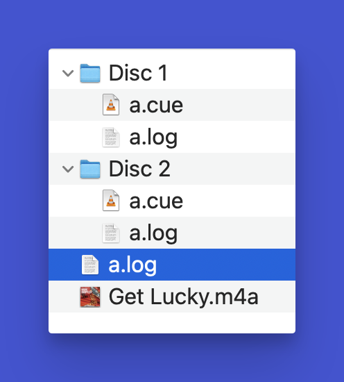

All works fine until I get an album with <Disc #> subfolders. Although I think I may have tasked you with a similar issue in the past, I can't seem to get my head around making bits of code work properly. What I'd like to achieve is to extend the code so that if <Disc #>, then rename the support files in each subfolder, appending " (Disc #)" to the variable 'album_artist-album'.

2MR2PostOctober 13, 2025, 09:47
Hot topicRenaming non-audio files in subfolders
Hi Andy,
It seems as if the solution would be simply doing another Contents of Folder asking only for folders. Using a regex to trim the list to those starting with Disk # ... then process each folder.

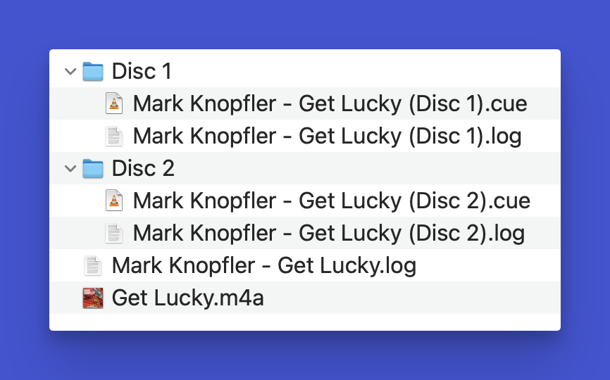

These issues may have been irrelevant depending on your files and workflow. Regardless, I've fixed them.
Download https://2manyrobots.com/actions/GV-Rename-Support-Files.zip
I've documented the action ... somewhat. The regex you used referenced 'support_name' which was never set. I'm no longer using the regex. It was easier to use lists and do all the renaming on a single statement rather than looping.
I've bumped the version number to 0.3
Let me know if I've missed anything.

I've uploaded v0.4 to:
https://2manyrobots.com/actions/Rename-Support-Files.zip
It seems okay to me. Let me know.
