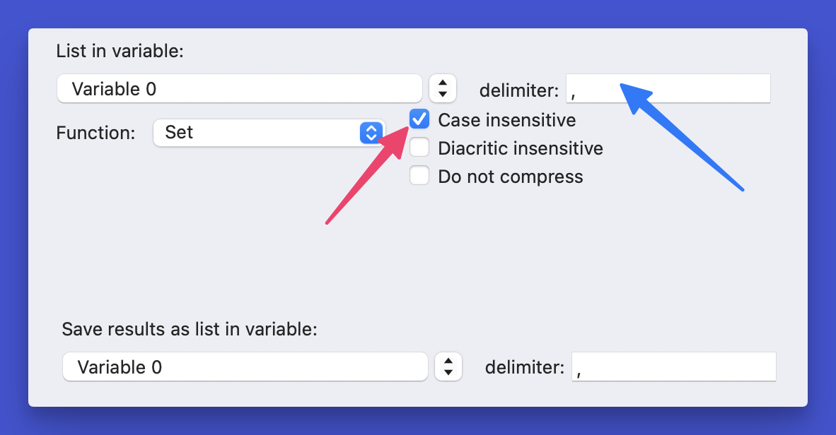

Copy the Composer field to Variable 0
List Manipulate save each unique case insensitive item in 'Variable 0'(, ) to 'Variable 0'(, )
Copy the Variable 0 field to the Composer field
The first statement copies Composer (for every file) to the Variable 0 field.
The 2nd statement is a List Manipulate statement. It uses a Set function (see the screenshot) to rebuild the lists stored in each Variable 0.
The 3rd statement copies Variable 0 back into Composer.
I've made the operation case insensitive. You can make it case sensitive by unchecking at the red arrow,
I've made the source and result delimiters comma-space. You can make this a little more forgiving if you wish by making the source delimiter simply a comma. Blue arrow.

Unfortunately when I drag the action into Yate it says:
Remove-Duplicates-from-Composer.plist was created by version 9.1 build 12662(12644) of Yate which is newer than the current version 9.0.0.1 build 12643(12478).
In any case I was able to recreate the action easily thanks to your suggestion, what I was missing was set as a Function.
It works flawlessy, as always thank you 🙂
