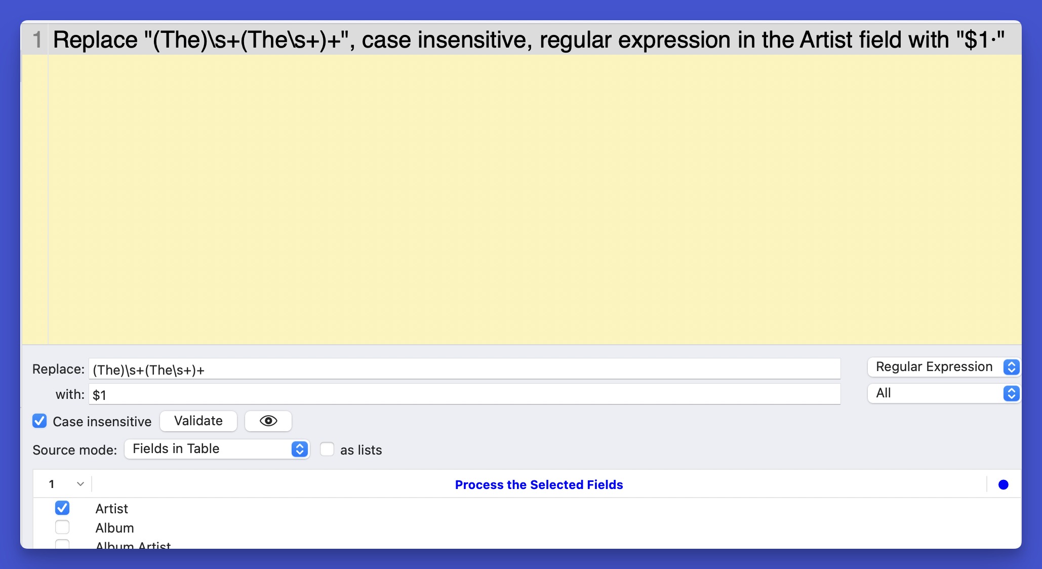

Do whatever you're doing and at the end of the action issue a Replace with regular expression as in the attached screenshot.
Select as many fields as you want. The statement will replace any sequences of the retaining the first. Alphabetic case is not significant but the case of the first the is retained.
Note that there is a space after the $1 in the replace template field.

Thank you! it worked! 🙂
