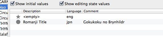

Okay something else that is strange - I noticed from this log that there the language of the comment was wrong and I tried to change it and that there was an iTunNORM comment I don't what is about. I tried to delete this comment and it deleted the description but remains as the default comment and can't delete it. And I can't figure out how to make the correct comment the default comment. I tried editing the incorrect one but then it just recreates a new empty comment of language eng with no description again. Screenshot of the comment panel below.

This comment thing is not just with this particular file, I went into another file that seemed fine that had a similar comment. Screenshot one is before editing. Screenshot two is after editing. It creates this empty default English comment as the default comment and I can't find a way to get rid of it. GRR 😯

The default comment as interpreted by virtually every audio application is the first comment with an empty description field. As Yate isolates the default comment for display and editing purposes, it creates a 'default' if it does not exist. When the file is written the default comment is not written if it is empty.
iTunes has the added constraint that the default comment has 'eng as its language. That is why there is an option on the iTunes preference panel to use the 'iTunes strict definition of comment'.
The iTunNORM comment is an iTunes item which contains their interpretation of 'replay gain' or volume normalization.
