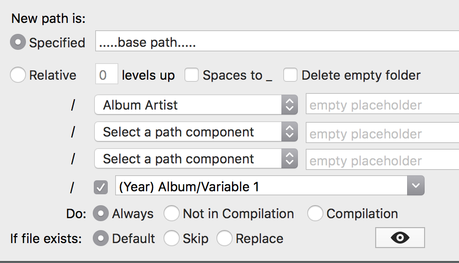

Ok, I am trying but I am missing something here is some screenshots to help explain what I am doing
Ok first here are my move settings
Next these are the complete steps to the action I am trying to create
Here are the rename settings used in the action
And here is my variable setting
But I got the error
New filename is empty
So I tried this,
I removed ❨Variable 1❩ from the ''(Year) Album/Variable 1' rename template, and that did do what I was expecting. The only thing is it could create problems down the road I am guessing
2MR2PostJuly 15, 2016, 16:13
Normal topicRe: Simple rename file/folder question
You've set a system variable in preferences....not a per file variable. System variables are 10 for the entire application. Standard variables are 10 per audio file.
You did not put statement #1 into the action. You omitted the following statement:
Set Variable 1 to "\u"'
Also, the (Year) Album/Variable 1 statement should be restored and there are some extraneous spaces in the template.
My, fault I'm working on the next update to Yate and I was too lazy to go to my 'release' Mac. I've now done so 🙂
I've uploaded a file contains a DeadmanMove action and the used templates to:
https://2manyrobots.com/actions/DeadmanMove.zip
Unzip the file and do a Yate>Import Preferences (with Overwrite as the conflict mode) on the DeadmanMove.plist file. You will have the DeadmanMove action. Take a look...it should make sense. I've used \h as a replacement for your Home folder so that I could test.
BTW: I've fixed the : in a constructed path bug.
