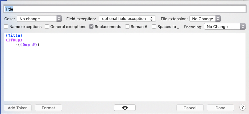

File renaming can be done in the UI via the File>Rename menu or in an action by the Rename action statement. All file renames are controlled by Rename Templates. Rename Templates are defined in Preferences - Rename.
Off the top of my head I can't remember which templates are built in. However, renaming a file to the Title metadata requires only a single token. I always recommend putting in duplicate testing just in case of name collisions. For example may albums have multiple songs named Intro.
I attached an image of a sample rename template for Title.
2MR2PostOctober 12, 2020, 14:38
Normal topicRe: tag to filename
Hit Post too soon. Filename is not a field which is why it's not on the Set statement. Filename is a Property.
