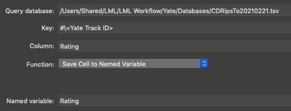

I've created a database and tracks all have a Yate Track ID. Thankfully, this tag is preserved by iTunes, so cross-reference should be easy. I just don't understand how to do a database query (when I try, with the database open, I get a message telling me I need to open a database).
