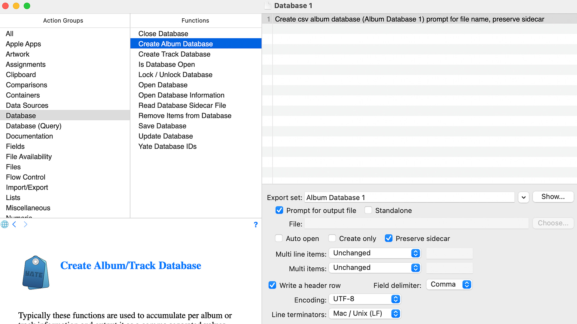

I did find the Create Database Utility action on the web but the graphic is different to the one I get. I'm using Yate version 6.13.2.2. The attached screenshot shows what I created but when I try to run it, I get an error message "cannot execute this action without selected files" but there is no guide on how or where to select the files.

I just downloaded the Create Database Utility and it looks 99% as it does in the documentation. A line of descriptive text in the main panel is no longer displayed. I've also just run it and it works as expected.
Download the Create Database Utility from the resources web page and drag the zip file to Yate's main window's file list area. You will then have a folder named Create Database Utility in the Action Manager. Inside the folder there is an action of the same name. That's what you want to run.
The Utility has a help button which gives an overview and describes how to get at the full documentation.
You've created an action which look fine ... but if you're getting warned about no files being loaded, you're attempting to run it outside the Batch Processor. All Yate actions need loaded audio files in order to run. You can get around this rule by marking an action as Always in the Action Manager. That supplies a dummy file if none is provided.
Regardless, you don't want to run the action directly ... you want to run it from the Batch Processor which is started by the Batch Processor Wizard menu item on the Actions menu. You do not have to create an action, the Create Database Utility does everything for you and allows you to save different profiles.
There is lot's of help on running actions and the Batch Processor. There's additional documentation on the resources web page. From the Help menu, do a Search Yate Help. Enter Batch Processor.

Thank you very much for your help. Both methods worked for me now, however I found running an action from the batch processor was simpler and gave an output file with just the headers I wanted. I'll have a good look at all the help information.
