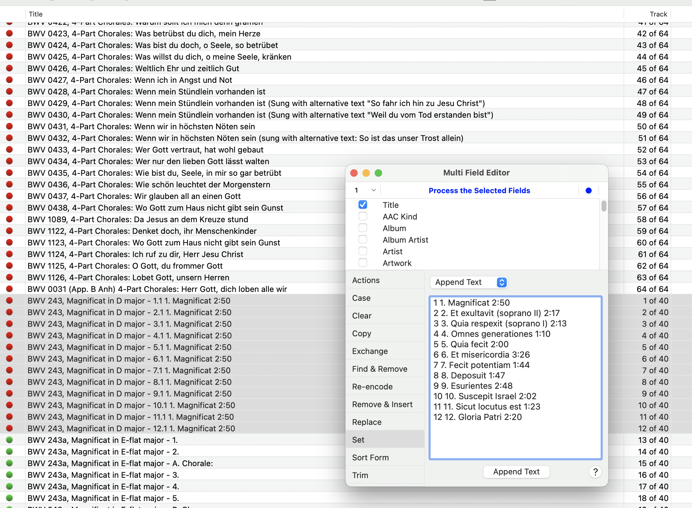

I'd like to append the text in the Set box (see screenshot) to the existing text in the Title column.
As you can see, I tried it & it just repeated the first line.
What do I need to do to make that work?

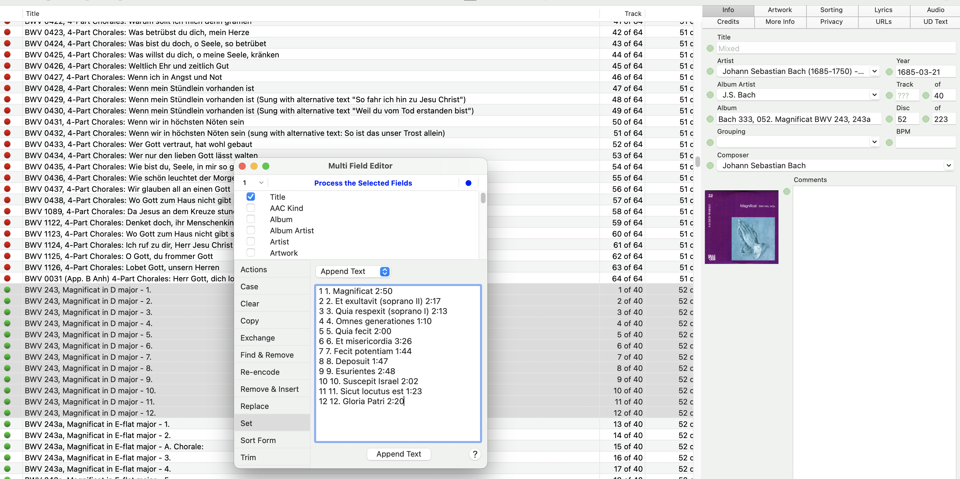

Here's what I started out with...
(Obviously, I could just paste the repeated part into my text file & do the numbering with the action you just wrote for me, but I'm wondering if there's a simple way to do this?)

Actually you appended all the text you entered to every file. You'll probably noticed that after doing it the text in the Title fields became blue. (Invalid characters in this case newline). The Set/Append/Prepend function uses all the text on each file.
Okay, you more than likely need a small action to call the Generic Text Importer and manipulate the result. I'll have a look.

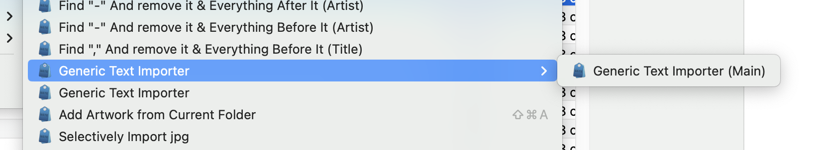

I have 2 generic text importers.
One works beautifully to paste in whatever's in the clipboard.
The other doesn't appear to do anything.
In the following screenshot, the one called "main" in the fly-out menu, is the one that doesn't seem to do anything.
The one below it is the one that I normally use, but it doesn't give any options to append or prepend.

I don't know how you ended up with an action and a folder. Somehow the Generic Text Importer action is not in the folder where it should be. The (main) action is a helper and can't be directly called. You must have received a pre-release as the (main) action should have grey circle for its icon.
