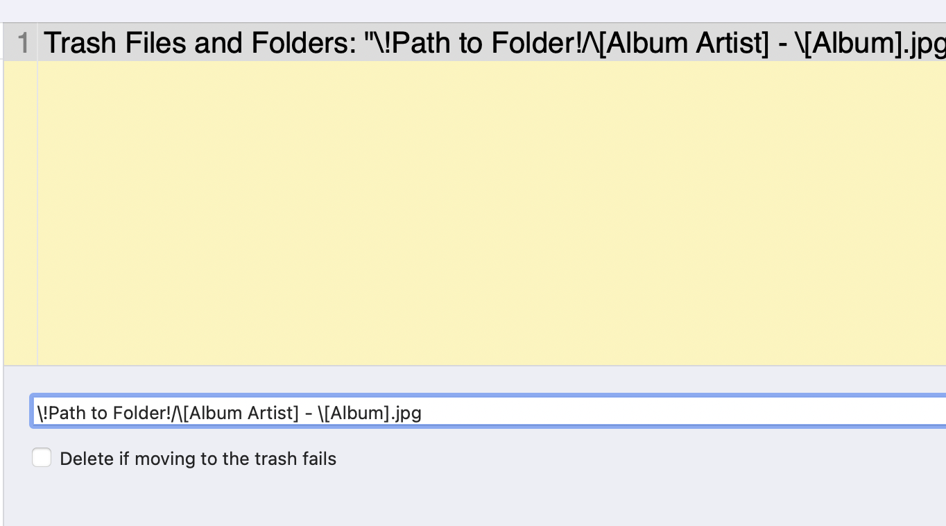

Escape sequences are your friends 🙂
The attached screenshot trashes the file but it will work with Delete Files and Folders as well. It will only delete one file. If you want it to be processed for each folder of a selected audio file it will take a little more work.

If you want to delete the files in every folder containing a selected track, the following snippet works:
Set Variable 0 to "\!Path to Folder!/\[Album Artist] - \[Album].jpg"
Build List with delimiter "⏎" in named variable 'Deleted Files' from field Variable 0 string delimiter "\~"
Trash Files and Folders: "\<Deleted Files>"

This is incredible! I continue to be blown away by the capability of Yate.
The first solution was sufficient for my needs. I tried your suggestion and it works exactly how I wanted it to.
Thank you very much. I really do appreciate the effort you put into your replies. 😀 😆 😀
