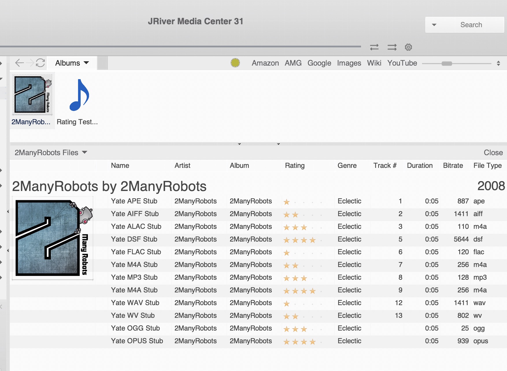

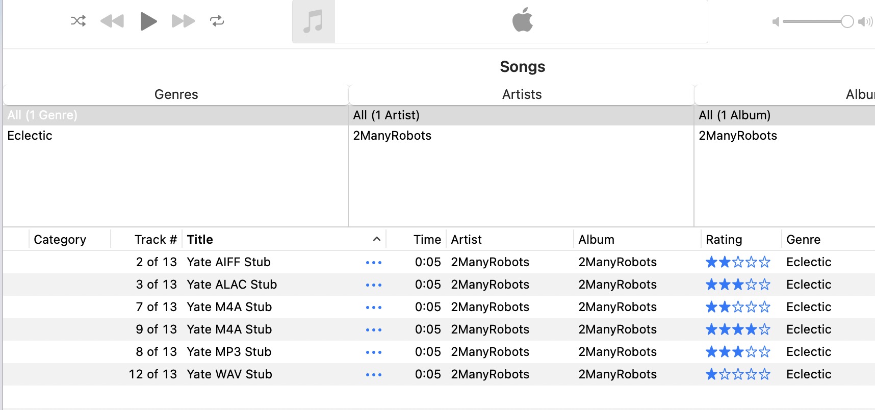

I just selected JRiver Media Center from the Application preset control in Preferences - Audio - Common.
I set the rating on various test files in Yate and put them in a folder supposedl managed by JRiver. The files appeared incorrect in JRiver. In JRiver I did a Tools>Library Tools>Update Library (from tags). I then added the files to Apple's Music application. See the two screenshots.
Everything seems fine to me. DO NOT SET THE APPLICATION PRESET. If you do you will mess up the ratings already stored in the files with a different encoding.
If you've already stored ratings in files with Yate they have to be converted to JRiver encoding. If you do a Help>Search Yate Help and enter Notes on Translating Ratings you'll locate the article which describes the process. When the process is run, any file with a rating will have to be rewritten. This process will not mess up what you have in Music.

I can't see any screenshots but they may not be necessary.
Great that's proof that you can encode files that appear correctly in JRiver and Music.
I said DO NOT SET THE APPLICATION PRESET because I assumed that you had audio files which had ratings before you set the application preset. Depending of the type of audio file, changing the application preset may make pre-existing ratings invalid. This is what I was trying to avoid. If you want to preserve existing ratings there is a procedure that you have to follow. If you're basically going to set ratings from here out, simply do what worked.
