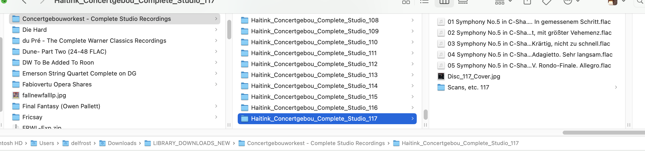

As you can see from the screenshot, I have a 117 disc box set. In each numbered folder is a numbered sub folder "Scans, etc. XXX" & in there is a "back" & "Cover" image.
What I need to do is to move the "Cover" image up a level & add "Disc_XXX_"
Where the XXX is the disc number.

Ah, yes... So moved up one level, no need to copy, I don't think.
"Disc_117_Cover.jpg" is correct, so that each cover image sits with the audio files & has the name number as the disc number.
So the result would look like the attached & all that would be left in the Scans folder is the back cover image.
