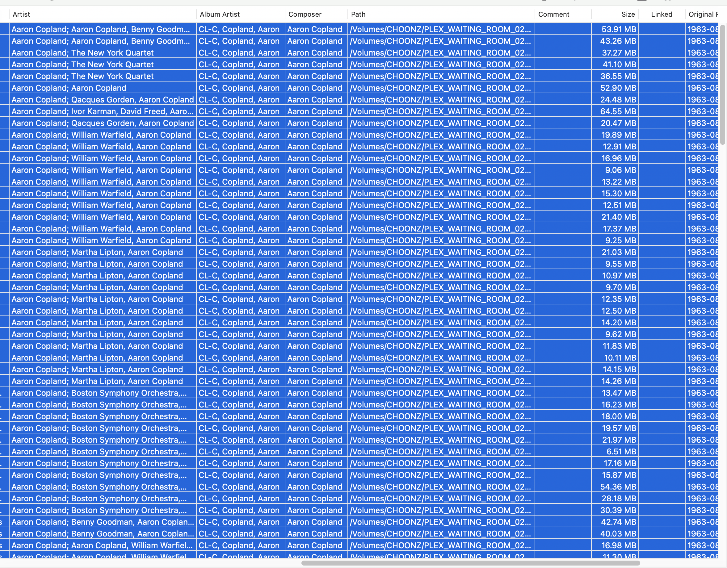

Hi there.
I've just updated to the latest version & at the moment, whenever I drag in a new folder from the file browser, the column widths seem to default to a set of narrow columns, rather than staying at the widths I'd made them. (Screenshot attached.)
What do I do to have them stay where I put them? I suspect there's probably a setting for this but I've looked & I can't see it.
Extra info you probably don't need:
Some seem to fit the contents, when the contents are all the same, others, like the Artist column, seem to truncate some lines but not others (like an average, maybe?) & the Path column is so short as to be meaningless. (That's usually my widest column. My workflow starts with me naming all the folders before I drag them in. At that point they will tend to sort by... I'm not sure, exactly but it will be something in the tags... But I know that if I click on "Path", the sort order will become the same as in the finder, which is the best start point for me. Obviously I don't actually need to see them sort but it is quite satisfying & handy to know that I don't have them in reverse order or something. Of course, because they're in the same directory I need to have the column dragged out wide as the beginnings of all the tracks in the sort column are the same.

The Settings - File List - Autosize column widths after loading files option was changed to be on by default. This was done as I was repeatably asked if there was such an option.
If you change the setting back to not checked things will be as they were before.
