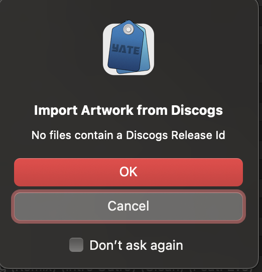

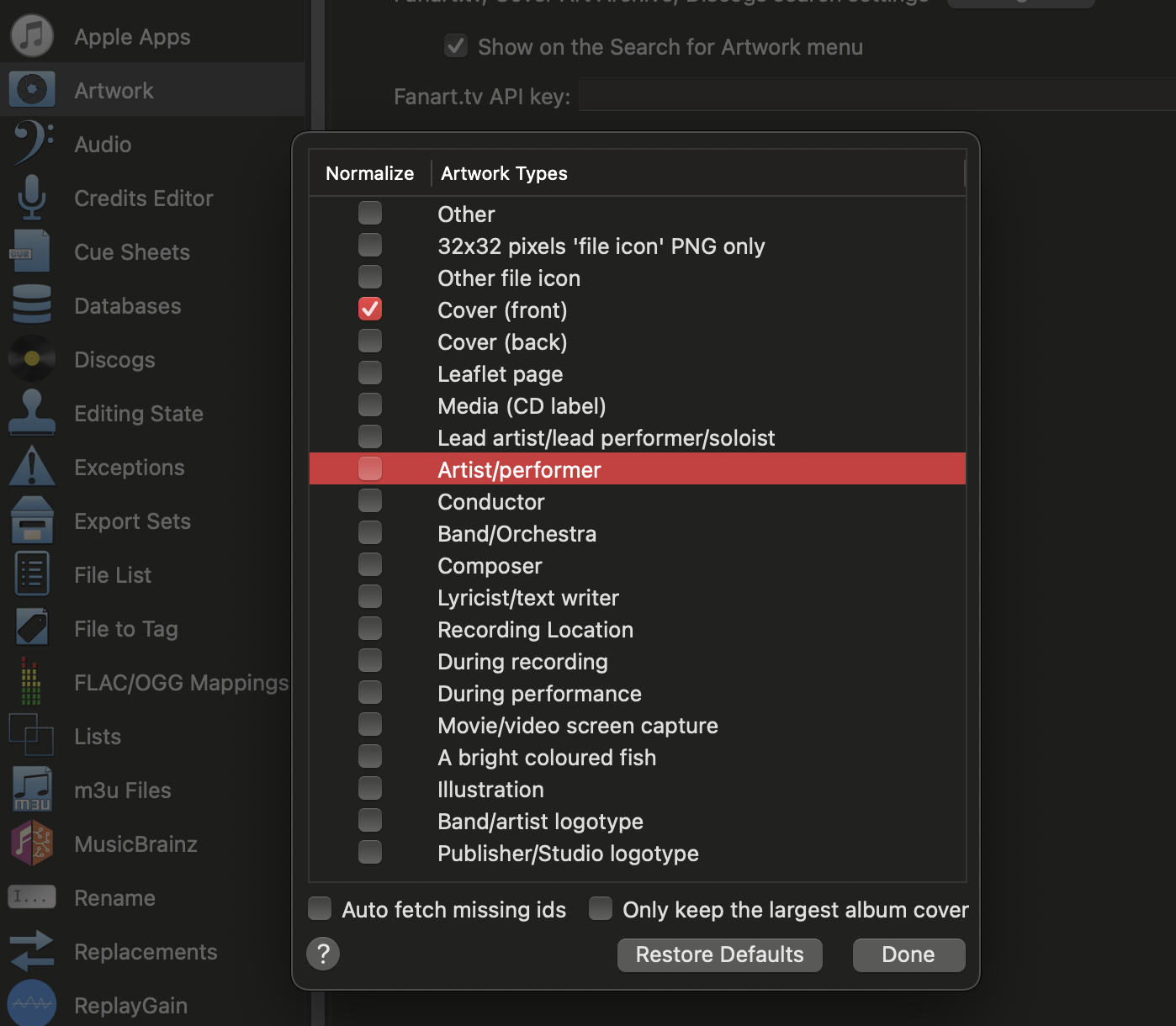

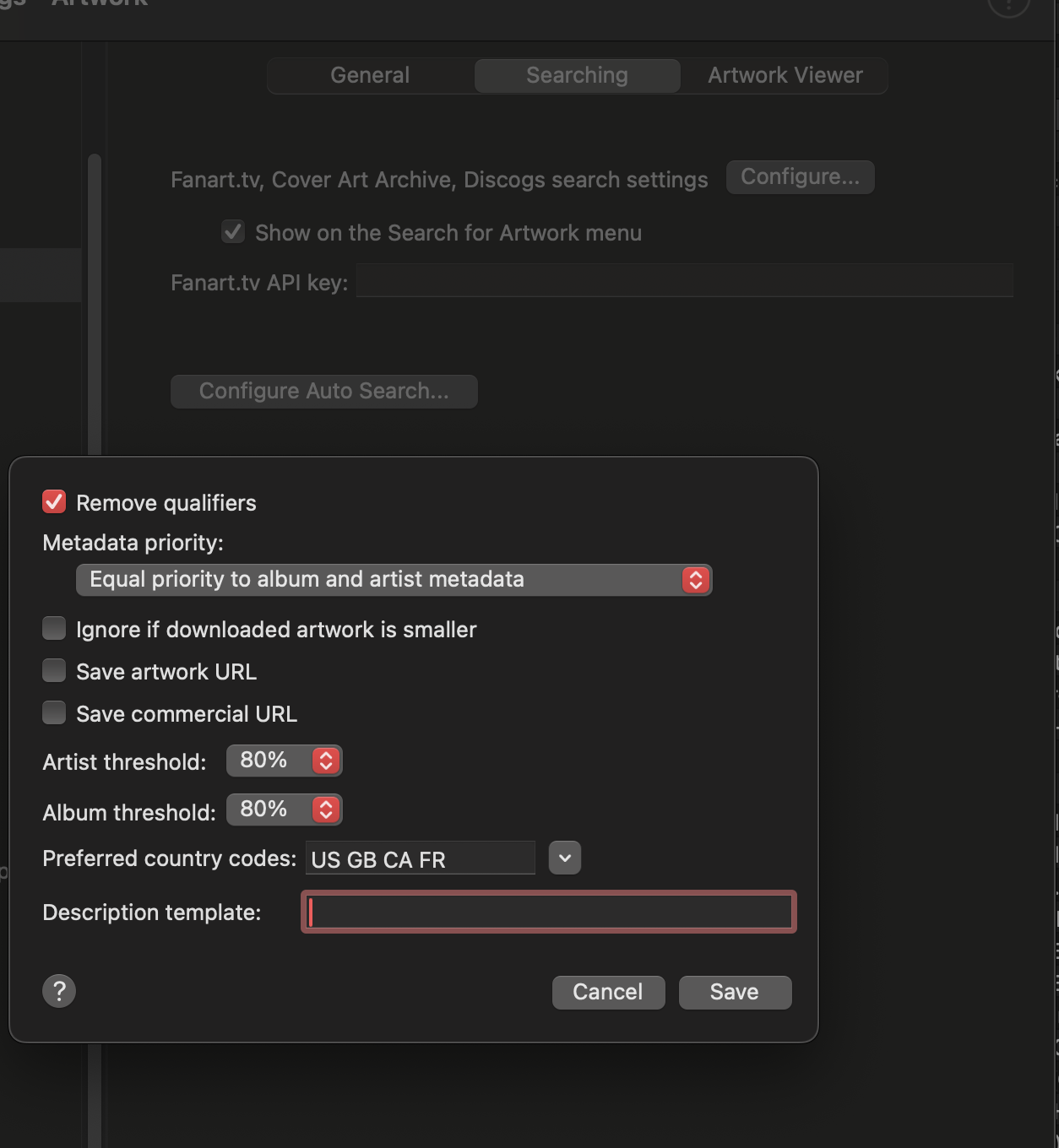

I have thoroughly reviewed all the settings and even performed the auto-search action, but unfortunately, I’m still encountering issues. I’ve included screenshots below to illustrate the problem, as I’m unsure what I might be doing wrong. Is there a specific method or feature that allows me to search for an artist along with the song title? Any guidance would be appreciated!

The error message you're getting implies that no Discogs information is available. All Discogs searches require Discogs IDs and Cover Art Archive searches requires MusicBrainz IDs.
If you want to auto search for missing Ids, enable Auto fetch missing ids in your first image. Other than that, your settings are fine.
You can try a simple Artwork>Search for Artwork>Auto Search. This will not include Discogs or MusicBrainz or Fanart in the search and may give you the results you want.
