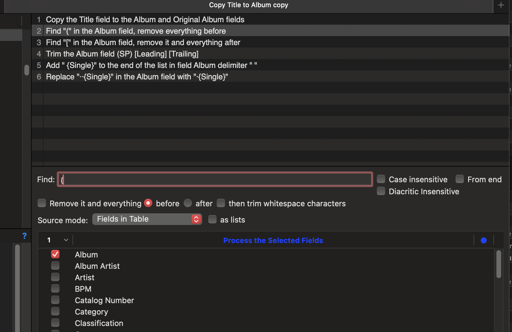

I’m working on a little project and need to take the title of a song, then copy it into the album field, making sure to add the tag {Single} at the end. However, I’ve hit a snag: I need to make sure to remove any text that appears in parentheses after the song title in the album field before replacing it with {Single}. Any suggestions on how to tackle this?
Example song title
(It's Just) The Way That You Love Me (Lnrp Mixshow Edit) (Clean)
Example Album
(It's Just) The Way That You Love Me {Single}
2MR2PostMarch 29, 2025, 22:38
Normal topicTitle to Album
Based on your example this should work:
https://2manyrobots.com/actions/Title-to-Album-Eliminating-Text-in-Trailing-Parenthesis.zip
DJunpridictabullPostMarch 29, 2025, 22:50
This is exactly what I wanted. Thank you very much!
