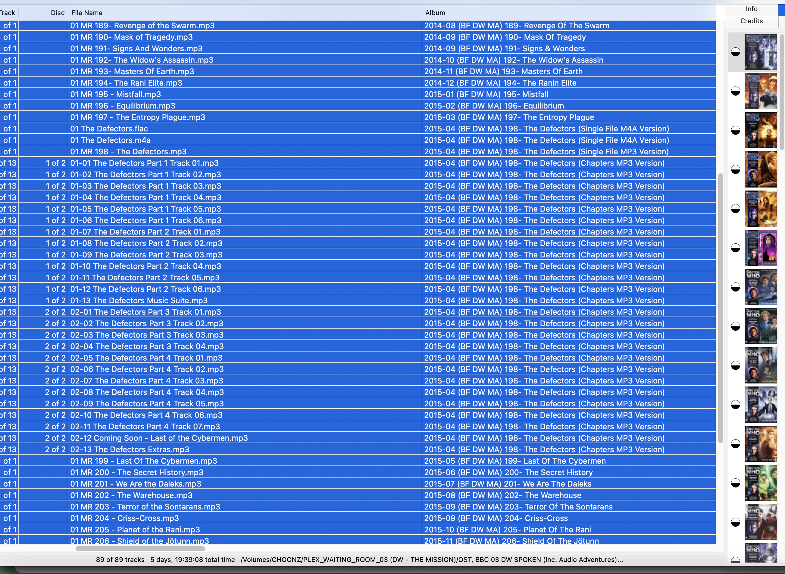

This is with regard to my feature request about knowing how many cover images I have loaded. (Because I'm currently editing batches of albums in a way that means knowing I have the right number of covers would be quite handy.)
As you can see from the first screenshot, it would be a right royal pain to have to count the covers manually. (Imagine if there were more. Hundreds, even!) But I now realise that my feature request could work just as well as an action. D'oh!

I've noticed that if I have a box set of albums & each album has a separate cover image in the folder (usually numbered to match the folder number), if all the cover images are the same image just with a different name, Yate knows that they are identical & will only show me one cover, even when all the albums are selected.
I'm not sure if that would be an issue for this action? In the set of folders shown in the screenshot, you'll notice that there are 4 different versions of the album The Defectors. Three of them have the entire audio-book as one track & one of them has it as chapters. All four of them use the same cover image with a name that reflects the version of the album they're for.
I suppose my point is that for this action to work, it has to be able to tell that 120 identical images with different names, one in each folder, will correspond to 120 folders. I just have no idea if that's an issue or not.

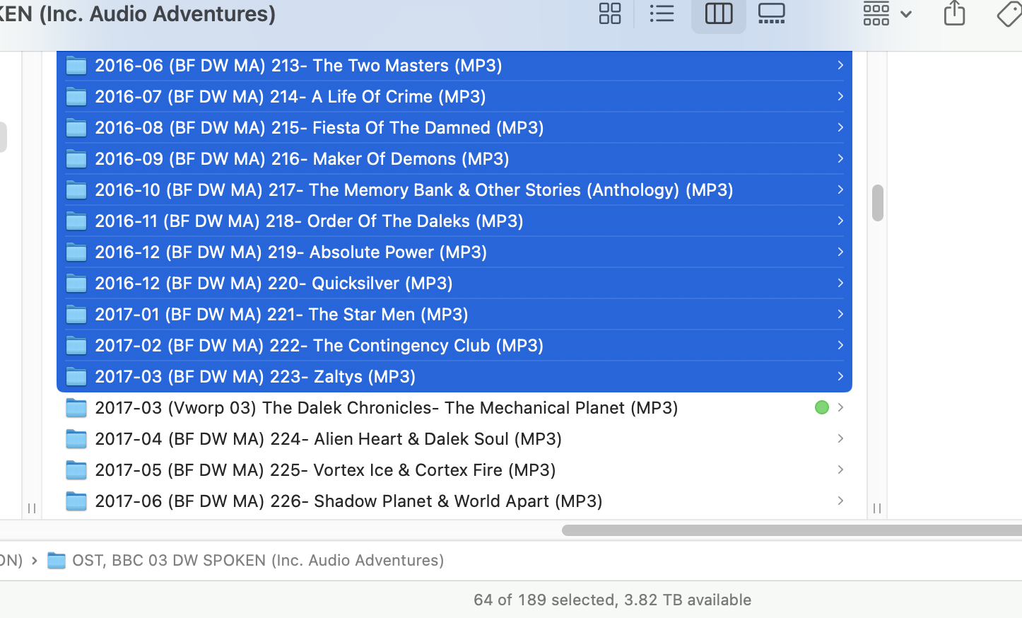

My workflow starts with sorting all the folders for a given artist or composer (or - in this specific case - Doctor Who Audio Dramas) in the finder. There are thousands, so I'm doing them in batches.
Once sorted, in each folder I'll have:
1. The tracks
2. A cover image
3. A folder called "Scans, etc." that anything else goes into.
It keeps it nice & clean & I have all my lovely actions in place to make light work of most things inside Yate.
Occasionally, when I cock up (like in the case of Absolution.jpg not having the word "cover" on the end) it doesn't come in with the "multi-cover imports" action, for the reason you quite rightly stated.
So here's my issue... The only way I ever find out that I've cocked up is to drop all of the albums into the library & watch them load in. Then, when one of them doesn't have a cover image, I can remove it from the library, sort out the issue with the cover & then put it back in again. Which can get fiddly & time consuming.
When I'm dealing with a small number... Say 4 albums, I can see at a glance that there are, for example, only 3 covers & go in to sort it out. When I have 4 albums loaded in Yate & I can see 4 covers, I'm good to go. But when there are tons of covers (like the batch of 77 I mentioned earlier) I can't see at a glance.
So all I think I need Yate to do is to say... You have 77 albums loaded/selected & there are (say) 75 images loaded. That's it. Then I can find which two are missing & fix them.
