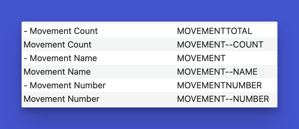

Go to Settings-FLACC/OGG Mappings
If Work Name is mapped to WORK, something has been changed. You can either set it to something else or do a Yate>Reset Built in Items>Reset FLAC/OGG Settings. Work Name cannot be mapped to WORK or the next steps will not work.
Change the mapping for Movement Number to be MOVEMENTNUMBER. If there is still a mapping of Movement Number to MOVEMENT, delete it.
Change the Movement Name mapping to be MOVEMENT.
If either of the changed items have more than one mapping, MOVEMENTNUMBER and MOVEMENT must be the first (preceded by a -). See the screenshot. The secondary mappings are read only and are not important.

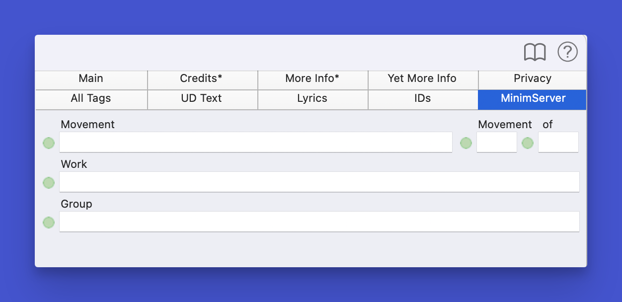

Download https://2manyrobots.com/actions/MinimServer-Edit-Panel.zip
Drag the zip file to the main window's file list area. Follow the instructions to install two custom fields and an edt panel named MinimServer.
Work and Group are custom fields which work with the same named MinimServer items.
The panel uses the standard Movement fields. While Movement is displayed as the field name it is associated with the Movement Name column. Work and Group will have available columns.
There's lots of room to add additional items to the panel if you wish.
