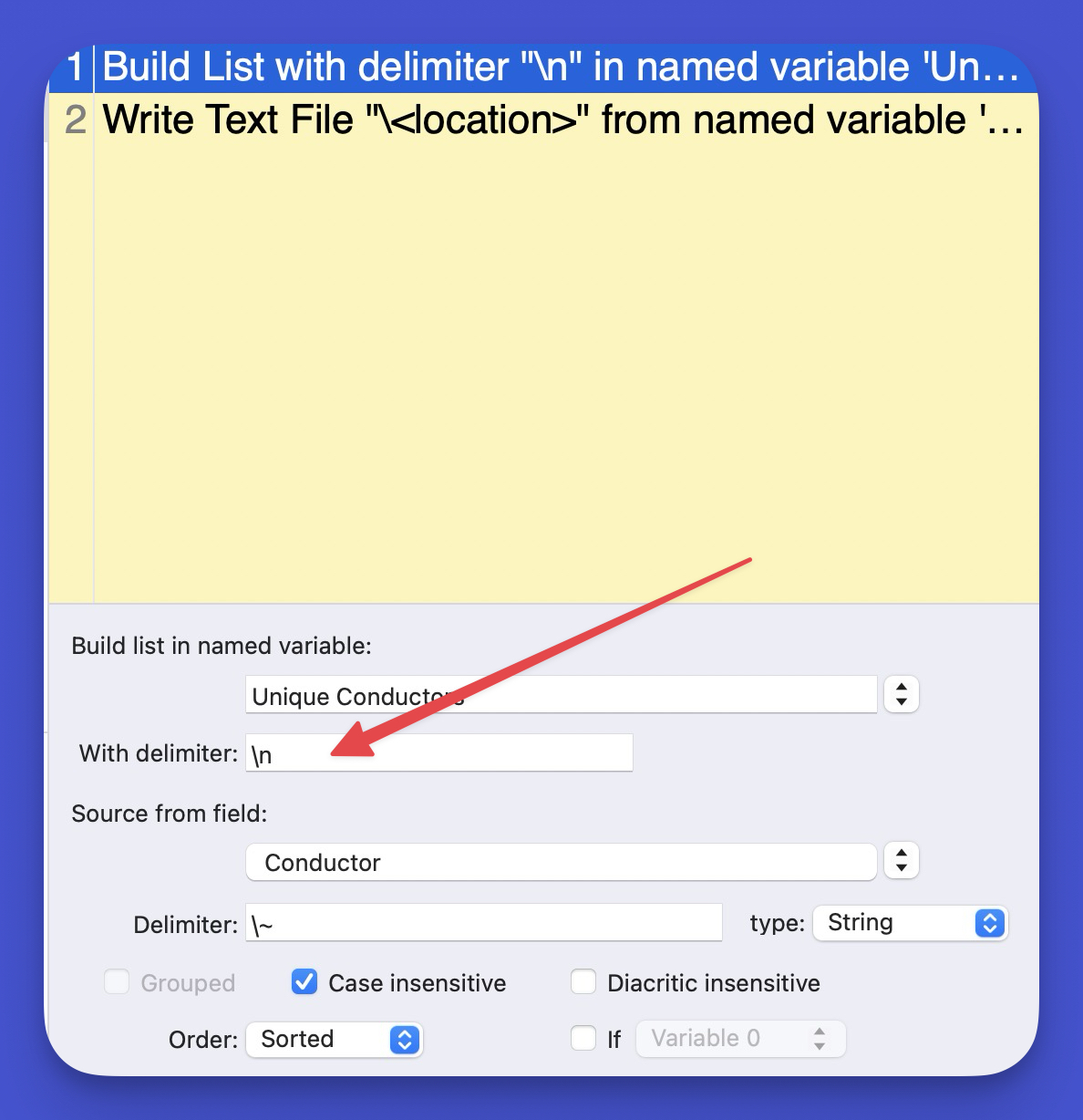

Thanks for quick reply. I duplicated the statements above and when watching the text file it appears the entries are getting overwritten on each line versus going to new lines so end up with empty file.
2MR2PostNovember 9, 2025, 08:52
Hot topicSimplest way to write selected metadata to file
The delimiter on the Build List statement has to be a newline sequence (\n). You might append a newline character to the list before you write the file, if you want the last line to be terminated.

Sorry, our posts were crossing. I've uploaded and tested the following snippet:
https://2manyrobots.com/actions/List-of-Unique-Conductors-Snippet.zip
