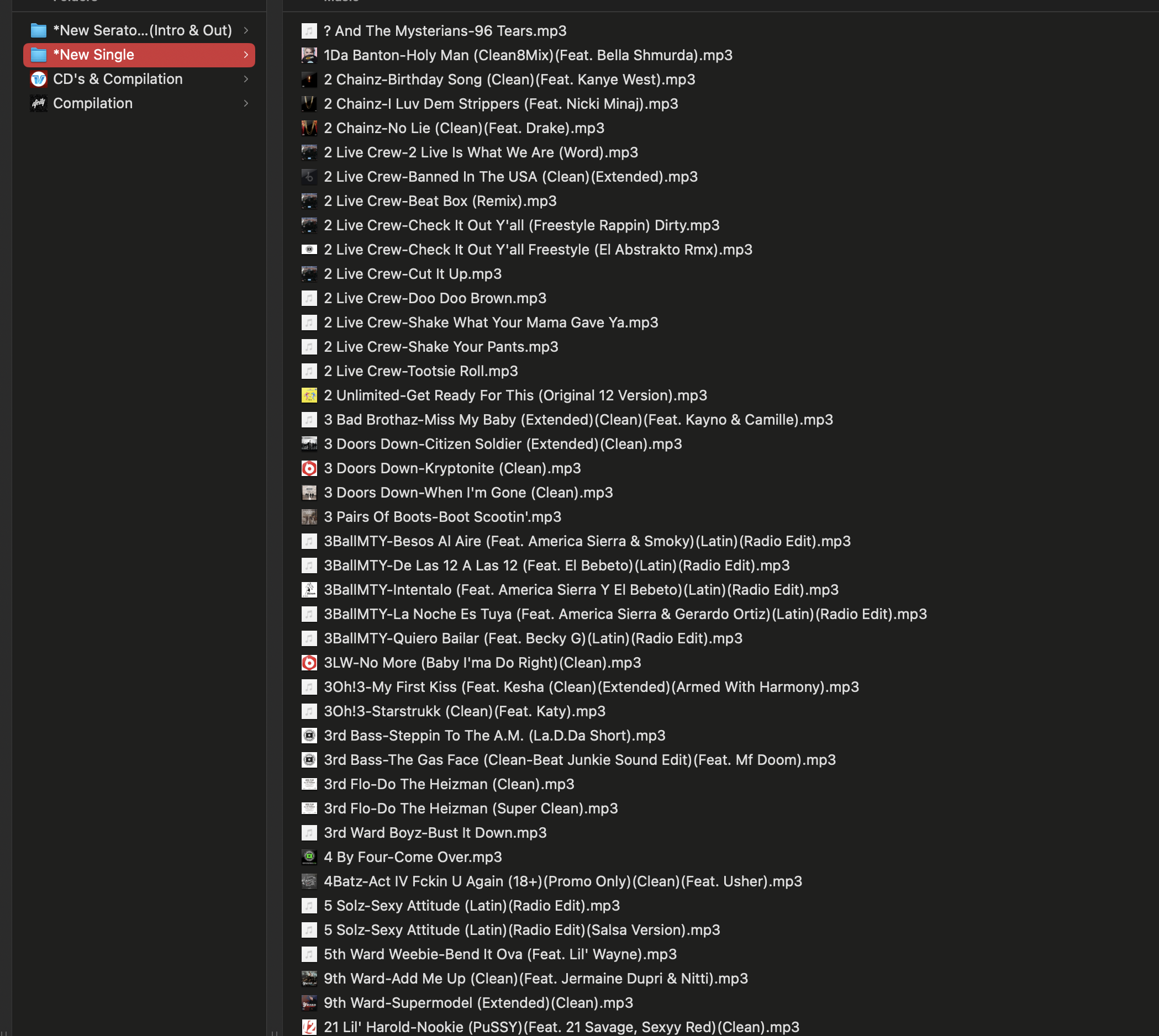

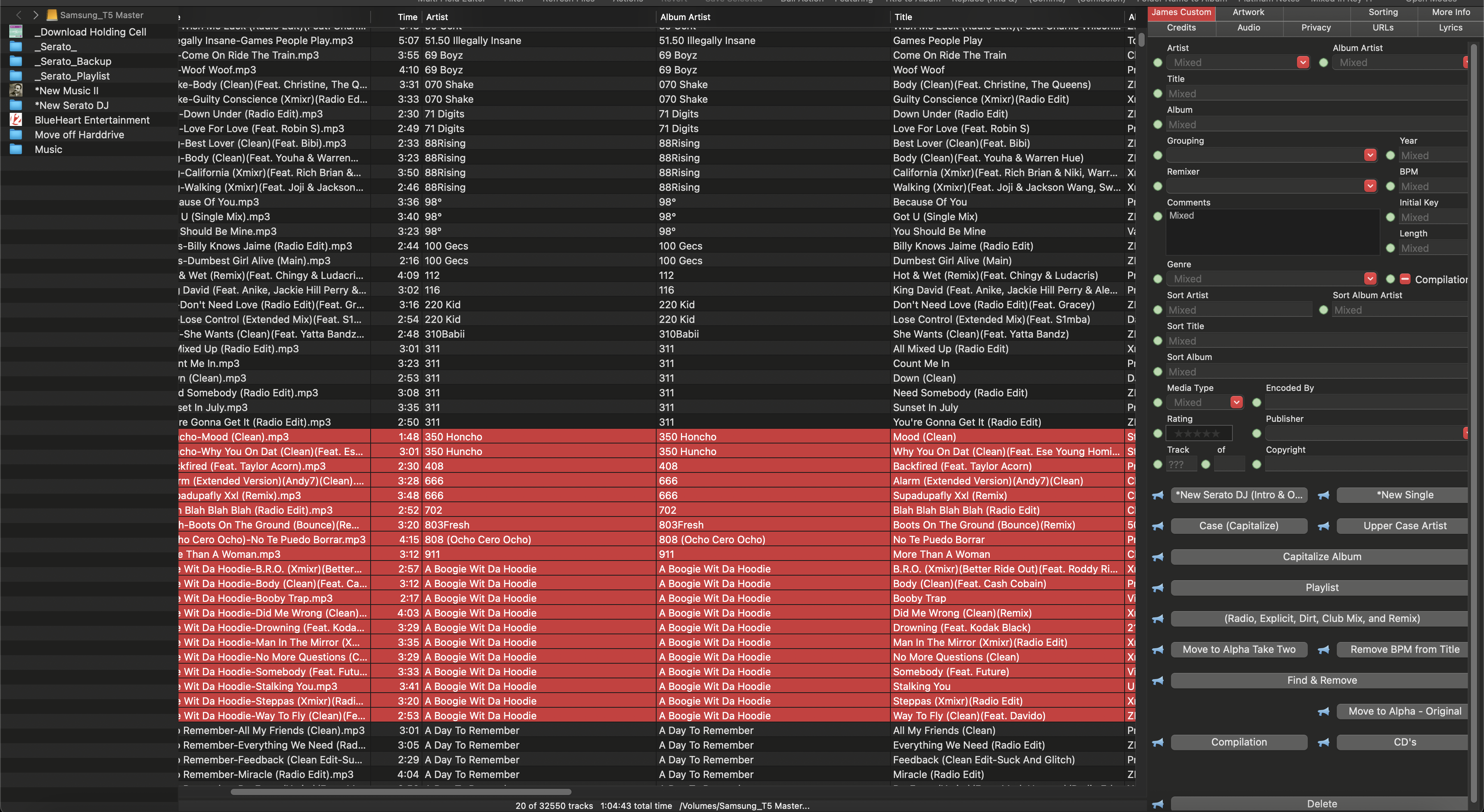

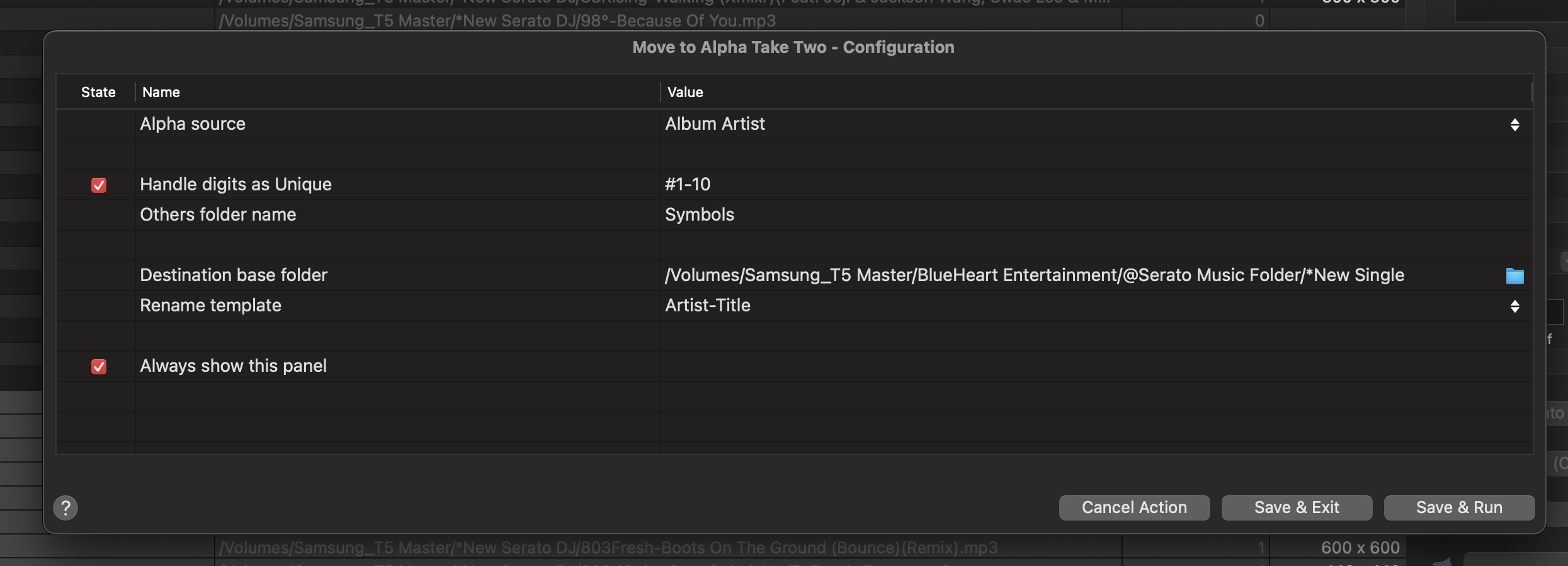

To give you a better idea of my setup: all of my music files are currently stored in a single folder on my computer. My goal is to organize these files into separate folders alphabetically, based on the first letter of each artist’s name. I was trying to use Move to Alpha Take Two to handle this, but it seems I might be missing a step or doing something incorrectly.

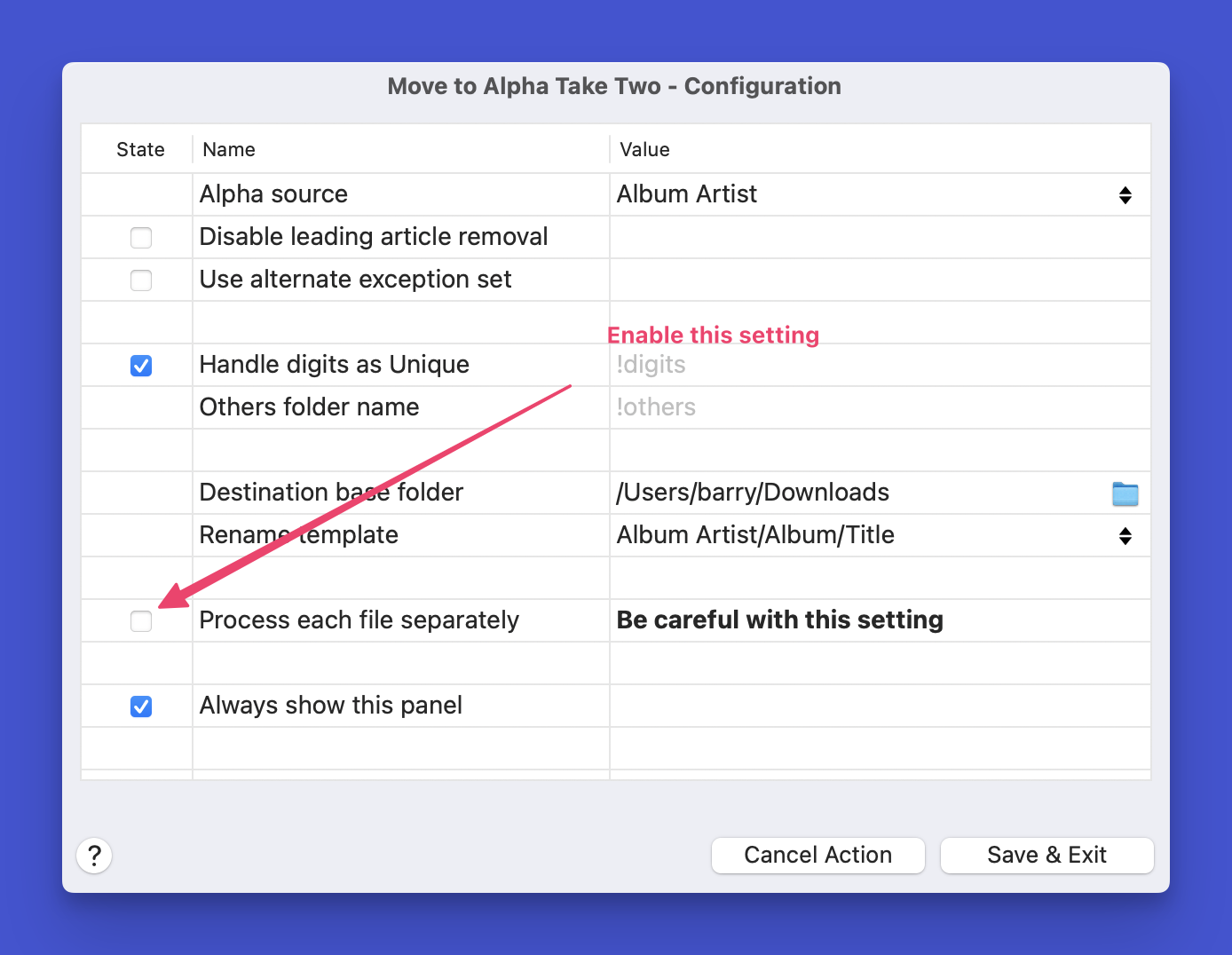

You are running the old action. Do a Yate>Check for Action Updates. If your files are all in a single folder you must at the least enable the new Process each file separately setting. The configuration window is scrollable and resizable. You may have to scroll down to see the required setting.
Also the rename template you specify has no folder structure to it. This means that all tracks will be placed directly in the 'letter' folder. If this is what you want great. However, if you want other folders you'll have to use a different rename template.
Your template for Bob Dylan would result in:
B>Bob Dylan-Title.ext
