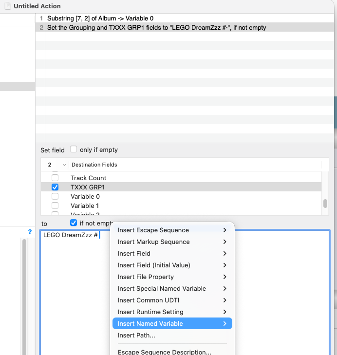

I am trying to copy a part of the album title to a custom grouping tag via actions. Maybe I did not get them properly but I was first trying to copy a part of the album title (complete title is e.g. "Part 01 - Title") via substring to a named variable. In a second stept I then wanted to paste the series name plus the part from the album title to the grouping tag but how would I insert the named variable there? Right-clicking brings up plenty of possible insertions but the variables sub-menu stays empty. Can I insert them manually?

Sorry for posting prematurely, I managed to get it right by looking at some sample actions and did it as follows:
Substring [6, 2] of Album -> Variable 0
Append the Artist field to the TXXX GRP1 field
Append "·#" and  the Variable 0 field to the TXXX GRP1 field

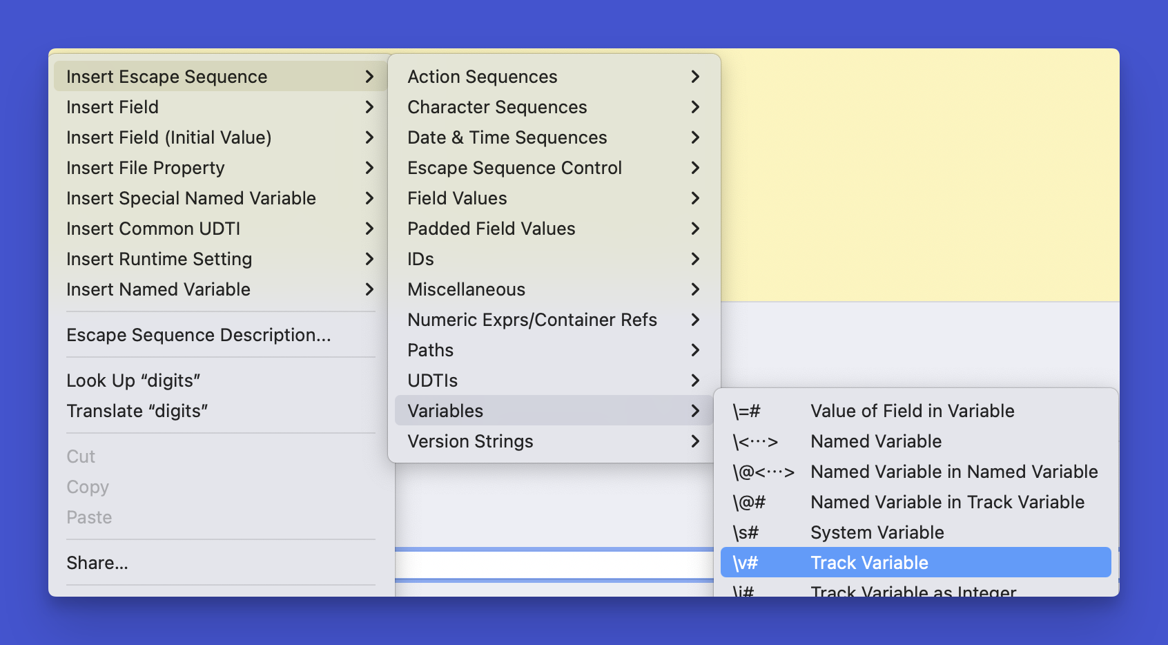

Variable 0 is not a named variable ... it is a track variable which in this case is exactly what you wanted to use. Track variables are inserted in text by a escape sequence. eg. \v0
Track variables can be inserted from the escape menu, however, it is usually simpler to manually insert them as above.
