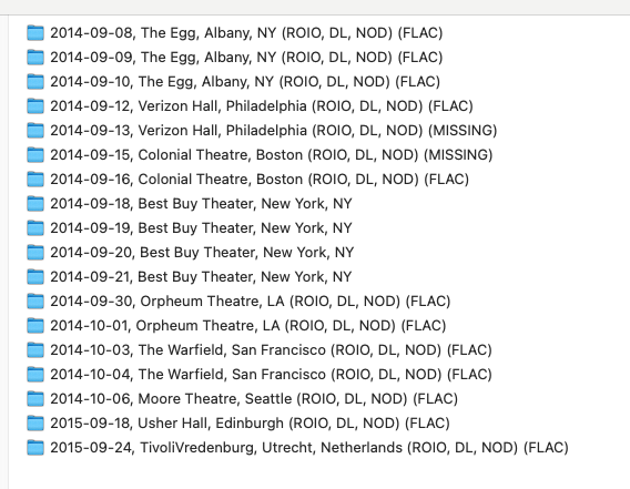

I have a text file which is a list of tour dates. I'm currently in the process of copying each line from the list & pasting it in as the name of an empty folder.
And then I thought... Hmmm... I wonder!
What do you reckon? Is it possible?
Here's the list (& the directory I'm creating, so you can see what the desired result will look like). I can point Yate at an empty folder, so it wouldn't have to worry about the few that are already there, duplications or whatever.

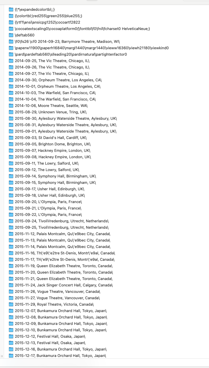

Well, I got what I needed, with a little extra. Some weird stuff at the top. Not sure if it makes sense to you?
Nothing I can't tidy up, though, while I add all the extra info.
Thanks. Once again, you've saved me hours!

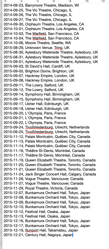

Hmm...some other the other folders have some weird items as well. There's two unknown for me, I don't have the text file and I don't know what the target filesystem is and how it handles things like accented characters. If you look in the middle, it's obvious that Québec was intended and not Qu\'e9bec. If you want to send me the text file (support@2manyrobots.com) and what the target system is ... I can have a look.
2MR2PostSeptember 11, 2026, 10:21
Posts: 2502
Normal topicGenerating empty folders with names from a text file!
The text file was an RTF file. The RTF encoding was causing the issues. I've updated the action at the same link to v2.0. It now strips RTF data and works as expected.
