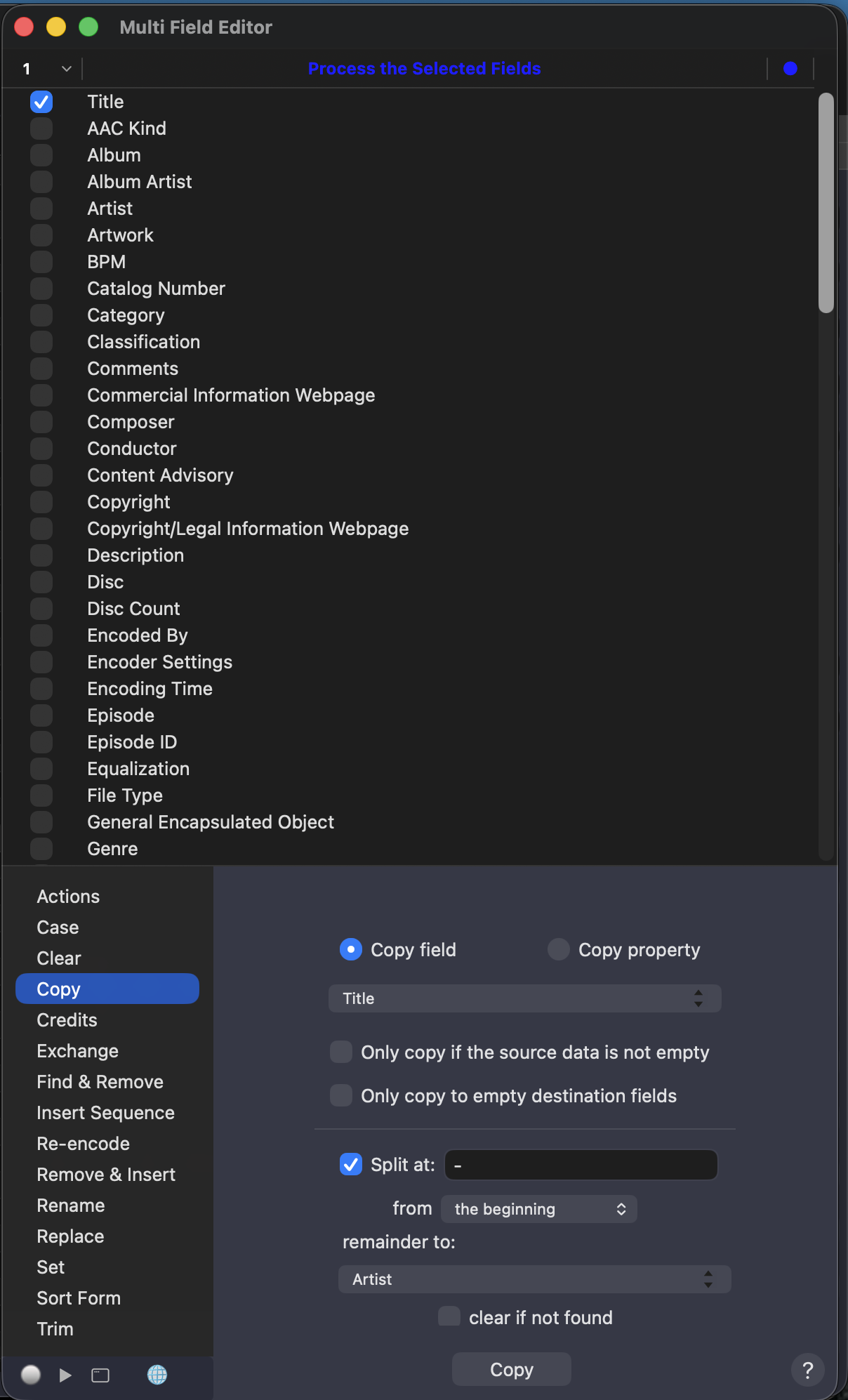

Is there a way I can create an action exactly like this?

Yes. Load up one or more test files.
In the Multi Field Editor, click on the recording icon (2nd from the left on the bottom).
Hit the Copy button at the bottom to perform the function.
Click on the recording window icon. (3rd from the left on the bottom).
In the panel that opens, click on the blue action button to save the items. The crreated action will be a duplicate of the Multi Field Editor function.
Turn off recording in the Multi Field Editor window.
