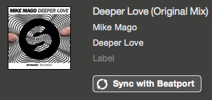

It's ok, because everything works fine now. But I need to use their official app called Beatport Pro that allows you to access database of their website. It basically goes like this:
    First put your tracks into Beatport Pro and Sync them with Beatport database. It will let you add all checked information into the tags of your tracks.

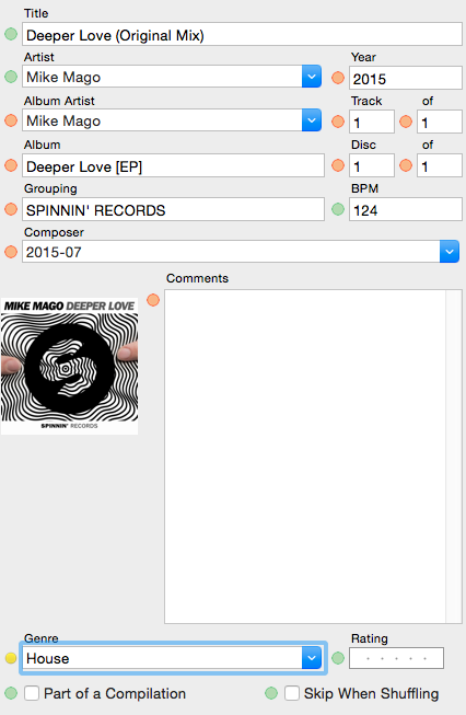

Also...in investigating I purchased some tracks and found that certain information is improperly encoded in the ID3 tags. In mp3 files Comments and UFIDs are malformed. In AIFF files, UFID files are malformed. In both mp3 and AIFF files the Commercial Information Webpage and the Official Artist Website URLs are preceded by a control character, making it not possible to launch the URL. I've sent this information off to Beatport but they haven't responded. I've put patches into v3.8 which works around the issues. You'll notice that there is no comment in your image above. There was one in the file ... but it was messed up.

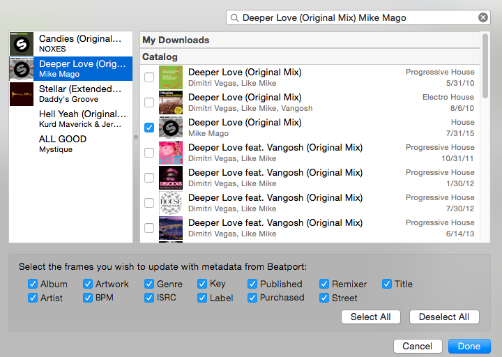

As far as synching on filename, artist, title, album....the issue is one of UI as opposed to implementation. Beatport's data base is fundamentally different that that of Discogs or MusicBrainz. The access is primarily organized around tracks as opposed to releases.
Extracting search results unattended via an action would be pretty dangerous as unless your metadata exactly matches the catalog representation you will get multiple results.....with no method of us weighing which is best.
In a UI based implementation we'd have to do a search for each track. We could then display the results and let you make your own choices. This would be somewhat like the AcoustID>Import AcoustID Recording Information interface. Is this what you'd like to see or were you looking for unattended metadata matching?
