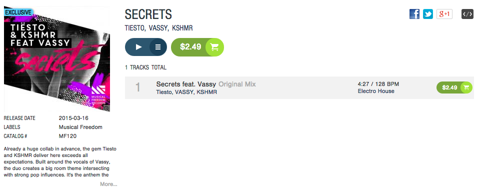

Here's example of the track that I'm unable to find using Discogs/Musicbrainz Wizard:
So it would be really helpful to have a feature that grabs tag info from beatport or another similar store.

The importing of metadata from Discogs and MusicBrainz is done via their APIs. Importing metadata from beatport or any other store would involve screen scraping which constantly breaks. Also we would be deluded with implementing the ability from dozens of different music sites. So....there is nothing on the horizon to do s. 🙁
