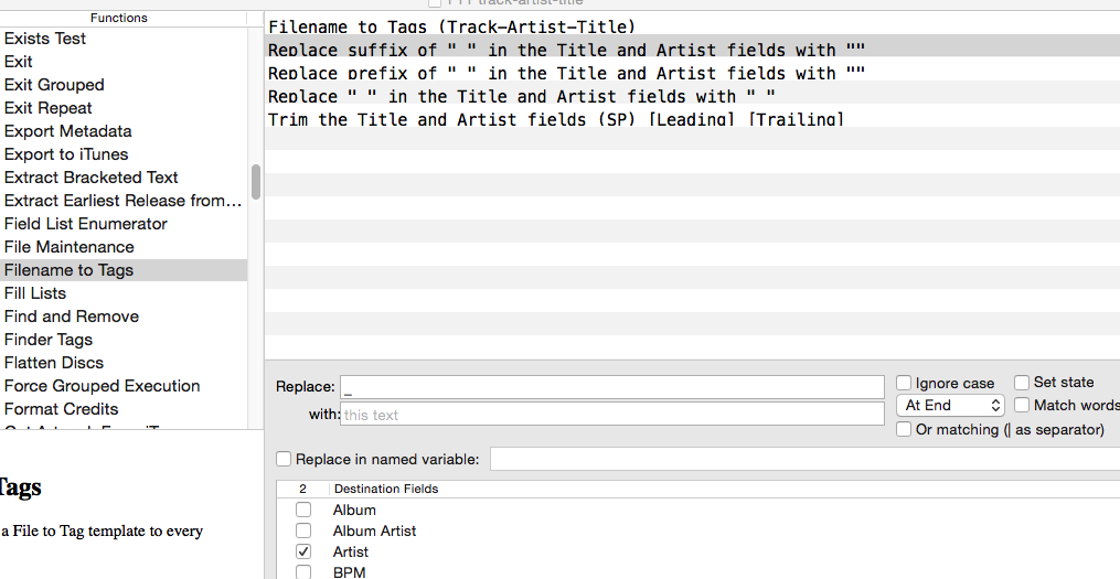

The File to Tag mechanism is a simple search for delimiters and save stuff between algorithm. All tokens must be delimited. Ignore is simply used to ignore text between two known delimiters.
This will work for all four examples:
FTT template: ❨Track❩-❨Artist❩-❨Title❩
action:
Filename to Tags (Track-Artist-Title)
Replace suffix of "_" in the Title and Artist fields with ""
Replace prefix of "_" in the Title and Artist fields with ""
Replace "_" in the Title and Artist fields with " "
Trim the Title and Artist fields (SP) [Leading] [Trailing]
The first two Replace statements are replacing with nothing. The third is replacing with a single space.

First, in the preferences -> File to Tag section, there's nothing that indicates that any special template is going to be used rather than the specified (Track)-(Artist)-(Title) tokens. Nothing there that indicates: use an action instead. We're creating a special kind of action, then? And now you need to switch between the Preferences and the Action Manager.
Second, in the Action Manager, it was not clear how to do "replace suffix" or "replace prefix" but I figured it out. For former you have to select "at start" and for latter you have to select "at end". Why not make the terms consistent?

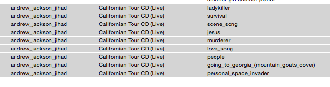

Third, I can't seem to enter an "_" as the replace term. It shows as a space:
Maybe that has something to with why the result of a test didn't replace the underscores:
Typically I send out packaged actions rather than the display text which solves the issue. I'm trying to get v3.7 completed and again I got lazy...in order to avoid going to a v3.6 release to build the action.
This is totally bizarre! What language or encoding is running on your Mac? (This should not make a difference as Unicode is used internally.) I certainly cannot make this happen here. I can see the underscore in the field, but not in the display. Can you please export the action (right click on it in the Action Manager) and send into me at support@2manyrobots.com. I'd like to see what is actually encoded.
