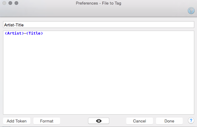

I am trying to do a Tag from Filename conversion, but am having a hard time knowing where to start. The Filenames are structured as "Artist - Title.aif". Is there a simple way to do this? I am not able to figure it out, and my "Action Manager" looks different than the one in the tutorial video.

For a simple extraction as Artist-Title you don't need to use an action. Go to Preferences-File to Tag and create a new template as described in the attached image.
Once your template is built, select some files and do an Edit>File to Tag>your template.
That should do it 🙂
