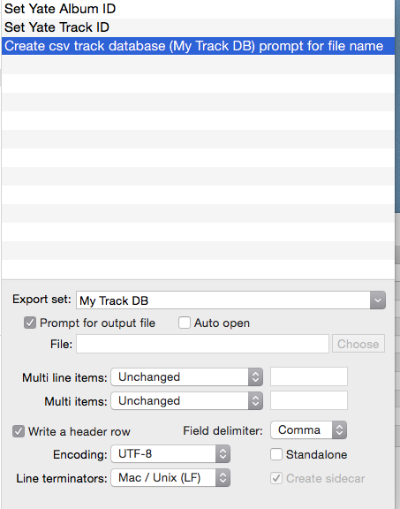

You can do it at the same time you generate the database. See the attached image. The first two statements are Database ID statements. Make sure you change the Export Set name in the Create statement to reflect your Export set.
Run the Batch Processor, select a similar action and run your entire collection through it. Make sure you select the Batch Processor Auto-Save option when it is displayed.
