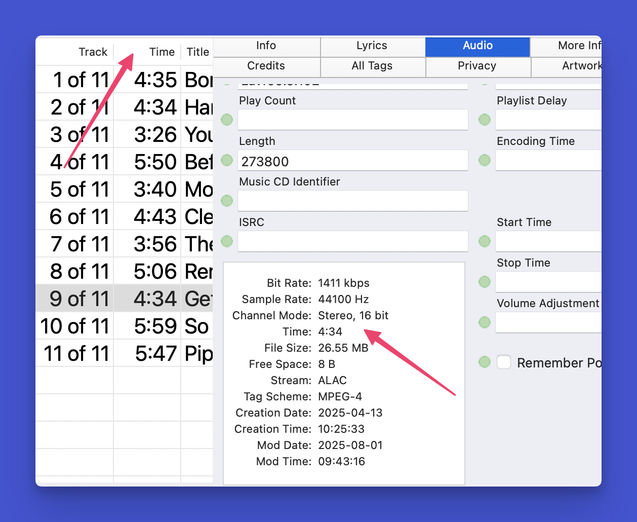

The Length field is in milliseconds and to the best of my knowledge is no longer used by any players or other audio applications. As the Length field is in milliseconds it is enforced to be an integer only value in Yate's UI.
Yate automatically extracts the duration of an audio stream whenever a file is loaded. This is also a value in milliseconds. All known applications, including iTunes and Music, extract the audio duration in this manner.
There are lots of ways to view a more readable duration in Yate.
- from the Audio Properties panel in the File Browser.
- from the Audio Properties panel on the Audio editing panel
- by doing a View>Get Info on a single file (menu or context menu).
- via the Time column in the main window.
- via an Edit>Snapshot and looking at the Properties tree.
