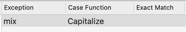

For now a two step process can fix the issue. In the first step do whatever capitalization you 'really' want. This will possibly mess up the word 'mix'. Create an exception for 'mix' which has a case function of Capitalize. (Exact Match should be empty). Do a second Case function (UI or action statement) which uses 'No Change' as the capitalize function. Deselect all options except for 'Do General Exceptions'. In actions the statements could appear as:
Case Title Case in the Artist field with Roman Numerals
Case No Change in the Artist field with exceptions
The options specified on the first statement can be whatever you wish. The second statement should not be modified. I've attached a screenshot of the exception.
