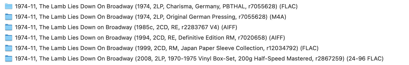

I would like all the tracks in the folder "2025-10, A Room Full Of Birds (44) (AIFF)" to have their Album field to be set to "2025-10, A Room Full Of Birds (44)" and so on.
[Yes, the 44 stays as it is part of my title string. In this case, the 44th album in the series. There will often be a larger section in parentheses in my album title before the file format, to differentiate different versions of the same album (see screenshot)]
I was certain an action could be made to do this but I somehow managed to build these & other rename templates before I ever started to ask you about actions, that's how long ago it was, so I've never needed an action. I just don't know why this has suddenly stopped working.
But yes, an action asking Yate to use the folder name in the Finder as the Album title for all the tracks in an album would be magnificent. Removing the file format as part of the action would be a bonus, even though I already have an action to do that.
