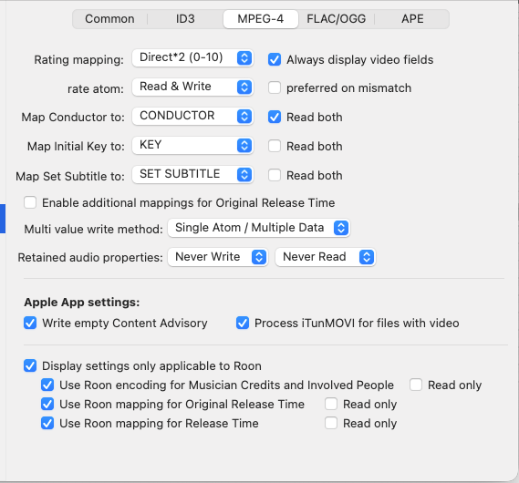

It seems like writing multiple data into mp4 files isn't working for me. I'm using the "Single atom/Multiple data" configuration, but the result still looks like this: artist1;;;artist2 (see screenshot attached).

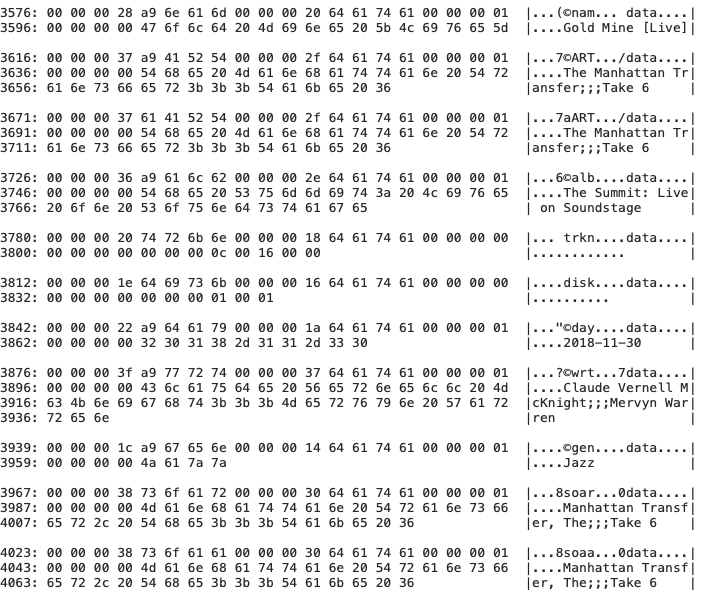

The Multi value write method is only applied when saving the m4a files. If your multi value delimiter is ;;; and you have Single Atom/Multiple Data set, each name will be written as multiple data items. I've just tested this by manually entering your data. Here's my results:
29142109: 00 00 00 44 61 41 52 54 00 00 00 26 64 61 74 61 00 00 00 01 |...DaART...&data....|
29142129: 00 00 00 00 54 68 65 20 4d 61 6e 68 61 74 74 65 6e 20 54 72 |....The Manhatten Tr|
29142149: 61 6e 73 66 65 72 00 00 00 16 64 61 74 61 00 00 00 01 00 00 |ansfer....data......|
29142169: 00 00 54 61 6b 65 20 36 |..Take 6 |
Re-encoding won't do anything as it starts from scratch and the multi value encoding is set when saving. You can test in Yate as follows:
- Set Multi value write method to Single Atom/Multiple Data
- File>Save Selected Files>Save Always (no metadata changes required)
- View>Raw Data
- Search for Take 6

Of course, I save all the files I edit. I just checked again and saved them twice via "save always", but the result is still the same—it’s different from yours.

The settings screenshot sheds the light 🙂
You're encoding for Roon which changes quite a bit. To the best of my knowledge Roon does not support Single Atom/Multiple Data ... but they will decompose based on a ; which allows ;;; to work. The MPEG-4 writer disables the atom format when detecting that you're writing for Roon.

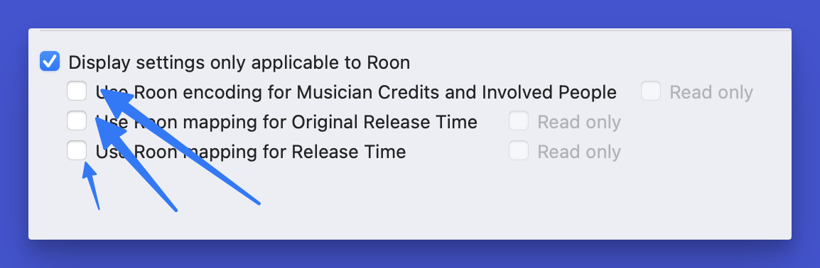

Hallelujah! It works.
That's interesting, it only works after resetting the settings to default. Enabling the Roon's settings just once irreversibly changes how tags are written. Disabling the Roon's setting and resaving the files won’t make a difference—raw view still shows “artist1;;;artist2.”

You don't have to reset. However, simply hiding the Roon settings will not work. You must uncheck them all.
